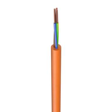

Would something like this work? Guess it would need a short extension length to go from the reel sockets to the van.

That is a 110v cable I would not use that just because it’s only rated for 110v as opposed to 230v.
it may work fine, but not worth the risk
