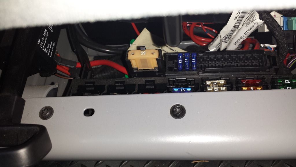

I have noticed the 80amp fuse advertised in the Essentials section of the club shop. Where does this fuse go and what circuit does it protect? I have looked in the manuals and have so far not managed to find out.
Being such a large fuse I would be a worried if the original one failed and would hestitate to shove a new one in without first knowing why the old one went west. Has anyone any experience of this issue and is there a common cause for failure?
The 80amp fuse is from the alternator to the leisure batteries

Is it common for this fuse to fail and if so is there a common cause? Where is it located on an SE?

I dont think its very common to be honest. Its located
Under the passenger seat in one corner of the fuse box
