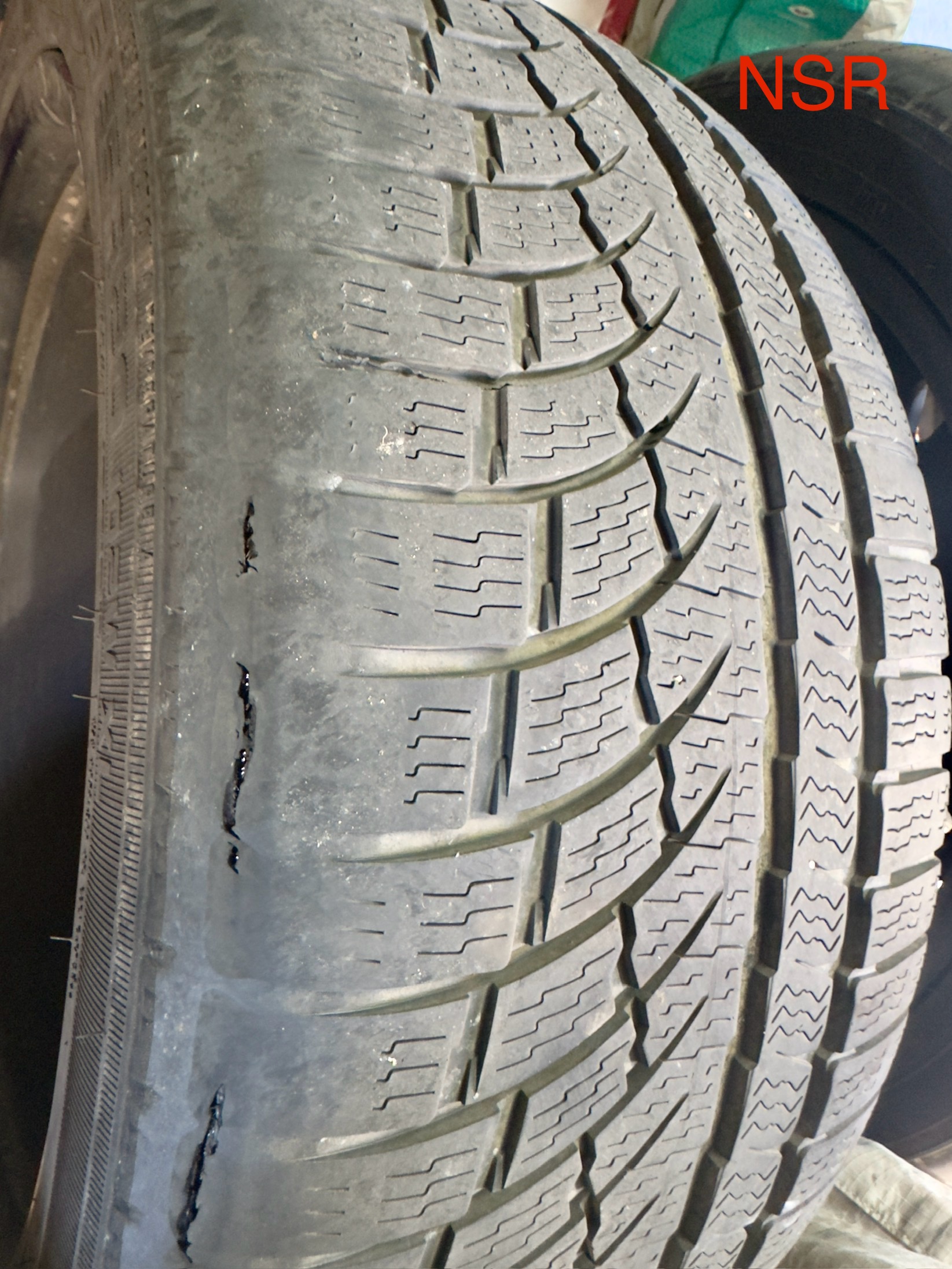

May ‘22 - had Bilstein B14 Komforts installed (Hunter aligned etc)
Jan ‘23 - returned to installer to adjust UP as the rear had dropped noticeably since install.
Aug ‘24 - same thing again - noticeable drop since last adjustment and noticeable Neg Camber as a result which ruins tyres.
Result - There was only 5mm upwards adjustment remaining so that’s been maxed out but the setup has already completely sh*gged the NSR Tyre inside shoulder. That’s about 10k miles for the knackered tyre & 22k miles total on the coilovers.
The camber is less pronounced now even for that 5mm adjustment, but still visible.
The wear was exacerbated by the fact that I’d left my winter tyres on instead of changing to summers in May - I broke my hand with the power wrench back in December, didn’t realise so didn’t get it set, went snowboarding, leaned on it, now it’s wonky and painful so rather than revisit that I figured I was only going to be doing around 3k miles or less over summer and I could live with that - but the camber has been bothering me.
Outcome: supplying dealer is now liaising with Bilstein UK (who say this is not a common issue) and are pondering a solution.
This also supports [mention]sidepod [/mention] comment in an earlier thread about weighing the corners when setting up. Suspect NSR has been battered because of road camber AND that’s the Gas and Water corner (although most of the time I’m not loaded up)
Interesting things- with camping gear on board (driveaway awning , cadac, gas and all the little bits that we carry) but not luggage passengers or water, the rear axle was coming in at 1410kg with the rear bench forward and 1,440kg with it in the rearmost position. (1,560kg is rear axle max permitted weight)
So if anyone cares - moving the rear bench forwards so the back is level with the sliding door takes 30kg load off the rear axle.
I haven’t, as my children are light, but I can imagine it’s really easy to overload the rear axle if you add adults, water and, bikes to the towel holder!
Now I’m considering going back to standard suspension with maybe some 18” General Grabber AT3 for all year round as I’m not sure I can be *rsed with this anymore and that will allow me to focus 100% of my negativity towards the saggy roof issue but I probably won’t fit in the car park where I go snowboarding.
Thought this may be of interest to anyone considering B14 Komforts which, apart from this, have been ok. Will update the thread if Bilstein come back to me.

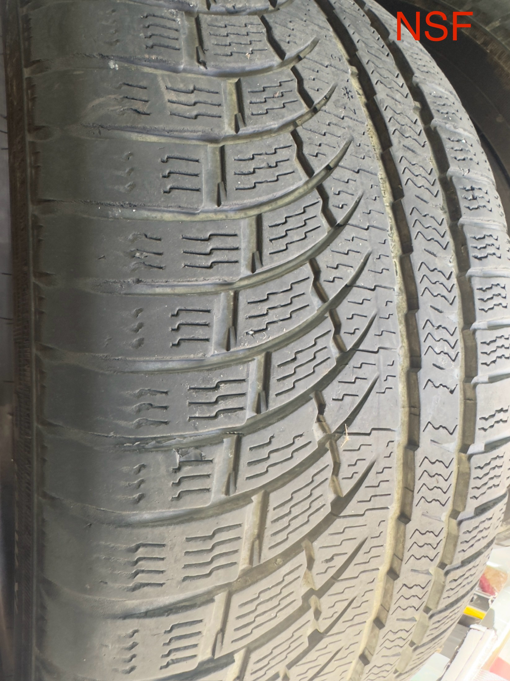

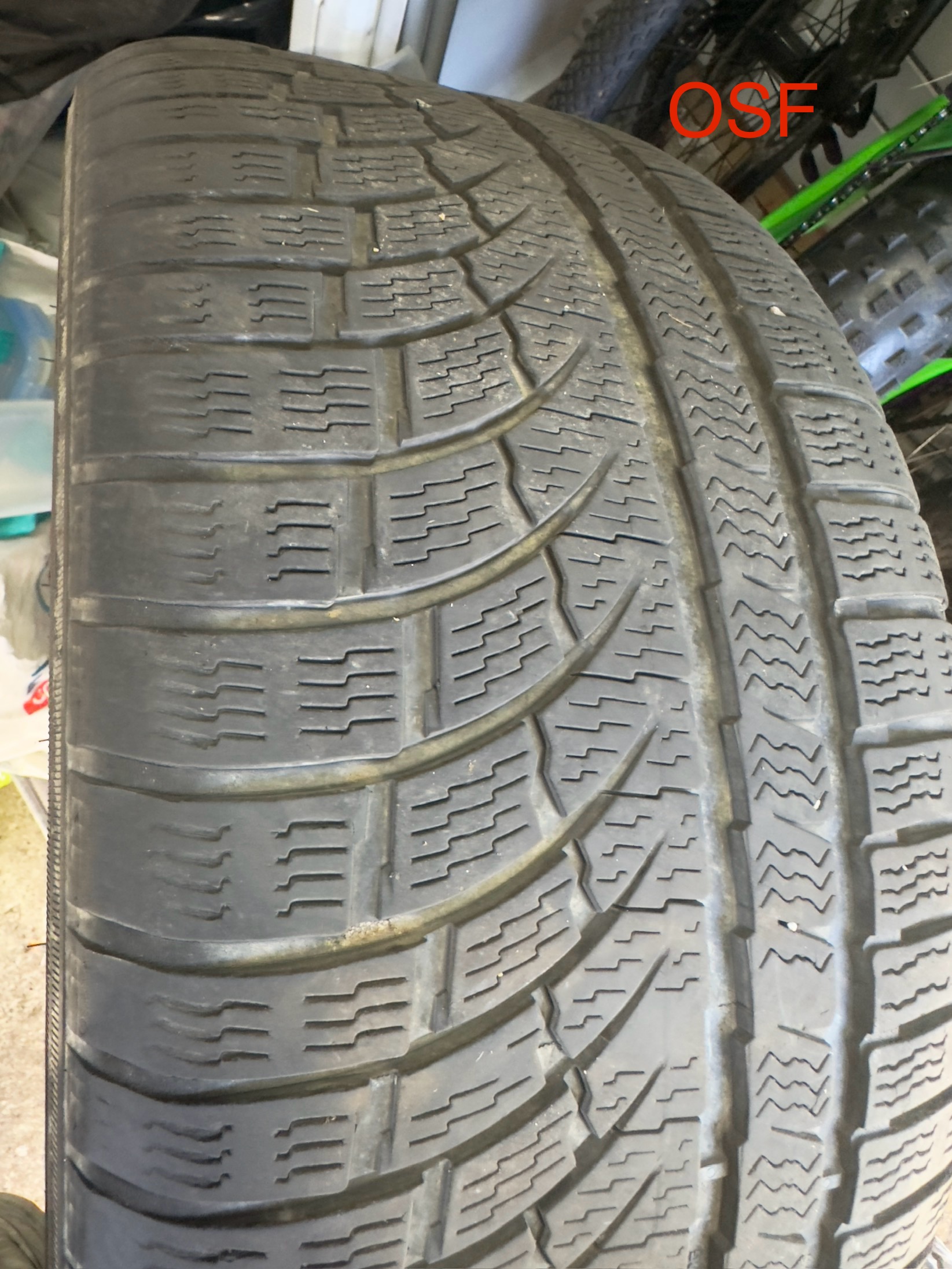

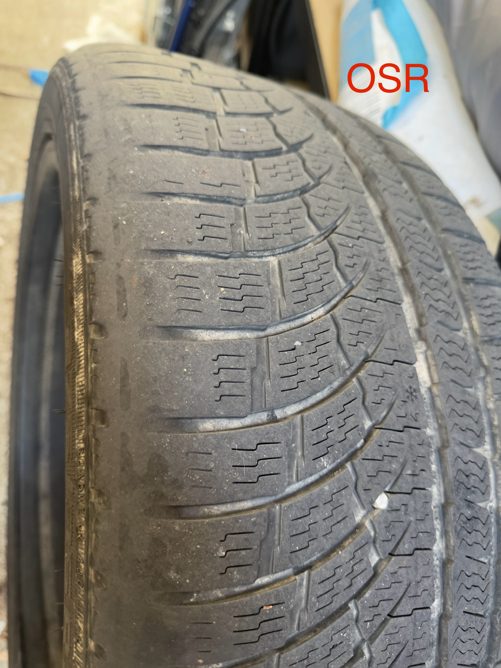

A decent set of tyres shredded. Basically like throwing £1k in the bin. Which is what I’m going to have to do to the B14 Komforts if a solution isn’t fourthcoming.
Tracking......The B14 Komforts is a rear coil (smaller), adjustable head and shock......the geometry for van is VW and limited. Hence I went with adjustable bushes but I never had a problem with rear tyres
Like a motorbike you can preload the coil......however the height range means the coil has to be smaller and less progressive as it has reduced travel. (Fundamentally you cant lower the vehicle if the coil is the same length)
I had a rear tracking issue on the original tyres when new. VW said it could have been a pot hole and not a warranty item.
Fronts wear look familiar.

Only just got in, this is the NSF tyre at 12k. (Only one at the moment that has reasonable access)

NSR and OSR after 12k ....psi 38 on the NSR hence the more pronounced edge wear as it's the heavy corner

UPDATE:
Back at the installers this morning. Bilstein said that this is an unusual scenario and have supplied a replacement set of (identical to previous) rear springs to be fitted.
Whilst this is good of Bilstein outside the warranty period, I foresee exactly the same sag issue happening again.
My previous T6 Beach had B14s (as opposed to Komforts) and they also sagged, to the point of contact, over time and I was told they were at maximum height. Stating the obvious - the Beach is lighter than the Ocean.
Bilstein state the drop range is -40 to -70mm. I think it’s -70mm or lower and would be interested to hear from anyone who has Bilsteins and is happily cruising round at a lofty -40mm. Maybe it’s a 4Mo thing.
So far, the kit has cost me an extra 2 installer height adjustments, a reinstall of rear springs, 2 hunter alignments and a set of winter tyres.
Hopefully I get to a happy place before winter tyre time. Thinking of ditching the summer/winter combo and trying some Continental All Season Contact 2 OR switching to 18” and 3PMS All Terrains
Arghhh not as bad as me....I had someone fit my powerflex bushes ( I dont have a car hoist) and they gunned everything back in. I gave him the benefit of the doubt on the front when the steering knuckle bolt was knackered as numerous people have been at the suspension.
However a simple job to replace spring cups has turned in ££££, and I've lost confidence, after failing to remove a snapped bolt , which is lowly torqued, and I was the one, previous to him, that removed / and refitted them with a touch of anti seize....... so I'm having both rear trailing arms replaced
