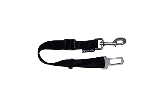

A great way to tether almost anything to the rear seat (whether up or down) to avoid it becoming a projectile under braking is to use the type of short seat-belt strap used to secure a dog harness. They have a spring clip at one end and a seat belt tongue at the other. Simples!
Loads of them on Amazon etc for a couple of quid.
