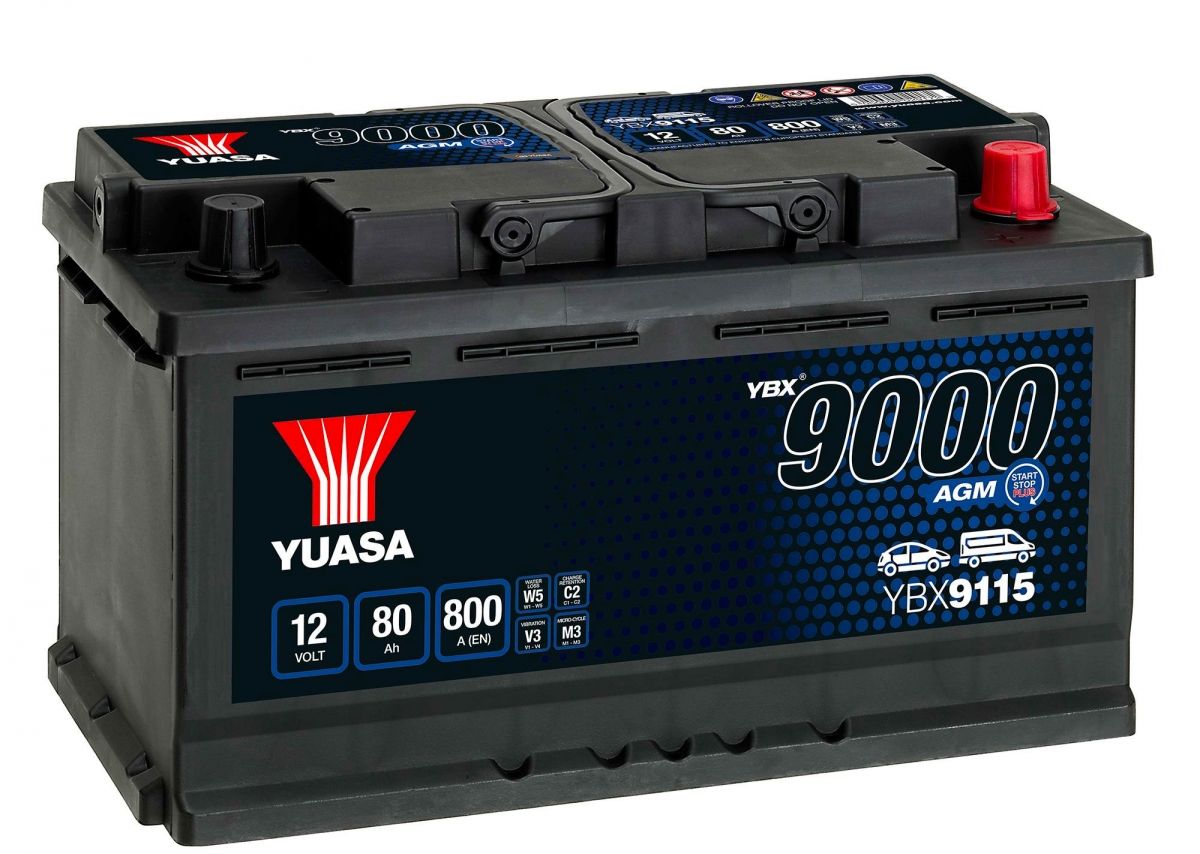

If your van originally came with AGMs I'd be happy fitting the same size Yuasa batteries. Yuasa has had a good reputation for many decades. YBX9115 looks like the correct form factor but do your own research.
True. Battery of choice for twin cylinder motorcycles with massive cranking amp requirements.
