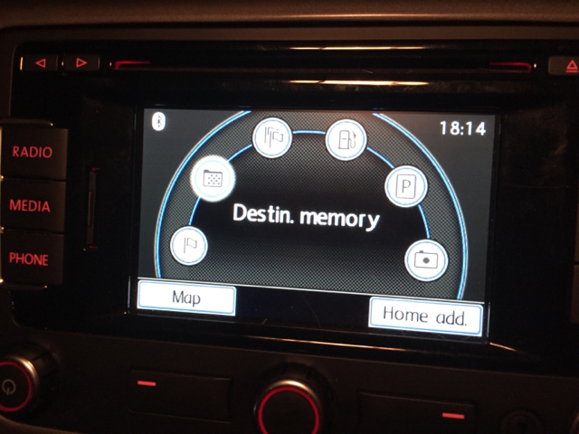

Once installed in your stereo you will be able to access them.

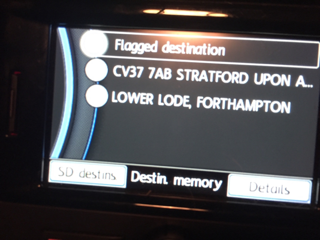

Select Destin memory

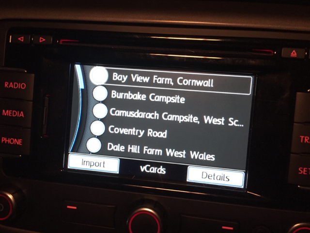

Press SD destins
Choose from the custom destinations.
I've added a few of my fav campsites to try it out works well. Also accidentally added the work location too.
