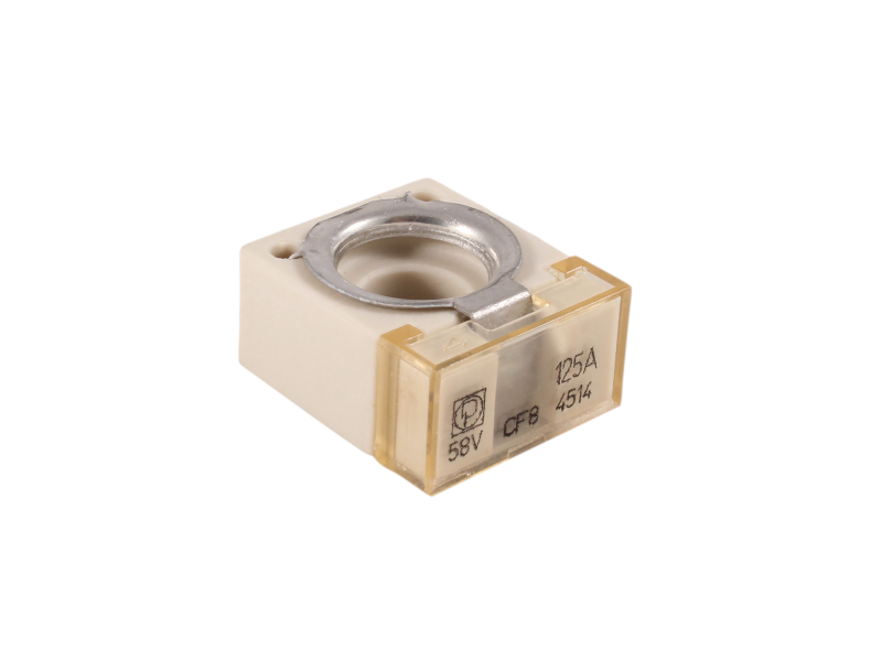

I would suggest fitting a 75amp cube fuse on the +tve terminal of the 2nd battery as well as fitting some form of Voltage monitor, even if it’s just a 12v socket plug in meter.

thanks for that advice, detailed and succinct! any idea where to get the 75amp cube fuse from?
I got one from 12volt Planet
These are only a fiver.
