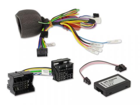

I have the same Alpine installed (T5 2012), you then need - Alpine APF-X300VW | CAN to UART-II interface (VW Golf 6/MIB-PQ) (voor parkeersenss and/or mfsw). Then you will see the sensors and the camera at once in your screen.
Thanks for that, really helpful helped me find the link below
