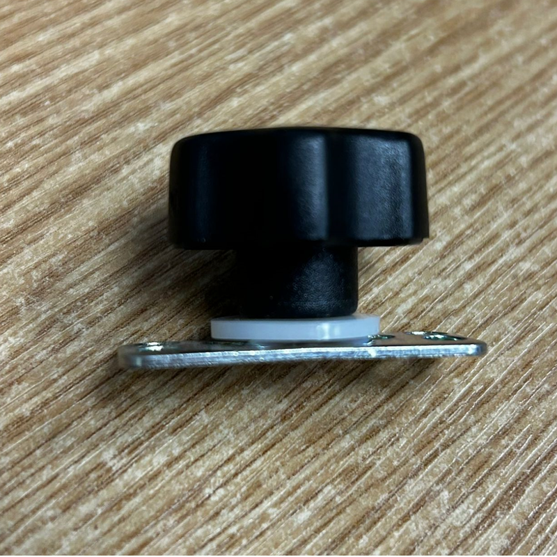

There are inserts that fit into the awning rail, they are supplied with roof toppers , they are derived from industrial fixings with a plastic thumb screw attached. The thumb screw provides the opportunity to attach ties / bungies etc to the thumb screw
They could be used to attach an awning to the van albeit they would not seal along the body line like using the Kador or Adapter options.
I'll find a pic of the fixing and post here
Edit: image from club Shop for reference (derived from an industrial fixing )
