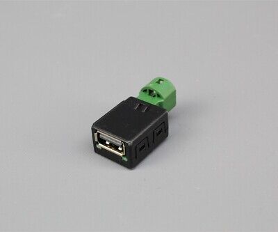

The USB port in the centre console of my T6 Ocean is starting to fail. I’ve tried multiple new leads and the same problem happens that connection drops unless I ‘waggle’ the lead. Very frustrating as I use Apple CarPlay for Waze when travelling.
Has anyone replaced theirs? How easy and how much does it cost please? Thanks
I have replaced it multiple times, once when upgrading head unit, then I modified my original facia plate to take a non VW USB connection and an audio Video Jack interface. Then when down grading prior to trading in I refitted original unit, bought replacement guts off of ebay from a LHD unit and fitted then in a the RHD body.

Thanks. How easy is it to replace please? I’m not very technical.
Where is your USB interface located? is it the lozenge shaped one just under the glovebox

Thanks. It’s this … port. It looks like it should just clip out.

Watched the video thanks. 21 minute 20 seconds it shows the inside of the cubby hold but the USB is blanked off. I may risk trying to flick it out with a screwdriver
It does look that way...but you will probably have to (use a trim tool) and remove the gearstick gaiter and then the larger surround to change the usb socket. unplugging it before removal, the green round connectors can be a bit of a pain
