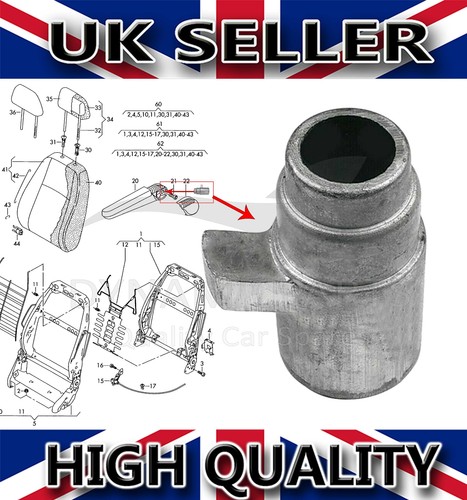

Repaired my arm rest today and replaced the lobbed boss. This is a not a replacement item from VW so aftermarket. The one I bought for £7.75 was nominally smaller diameter so I had to shim it out with tape (5 winds of electrical tape) in order to mirror the feel / movement of the original arms (a little too much play / too light without taping).
Worth sharing. Sadly VW only sell the complete armrest
I have to say I broke it last weekend and have been lost without it.
Hmmm, just found out that the profile offers slightly less lift than the original.... so I wouldn't recommend that one. It may be high quality but accurancy is another matter.
