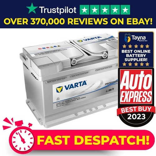

Varta LA80 battery from Tanya Batteries £144.46 via eBay free delivery. On offer until 21st February.

I'm assuming the above battery is the correct size(dimensions) as I haven't had chance to check mine.
It must be a thing with beaches, mines a 2013 and the battery doesn't seem to work well even after a long charge.
Same dimensions, straight swap for my 2012 Beach.
