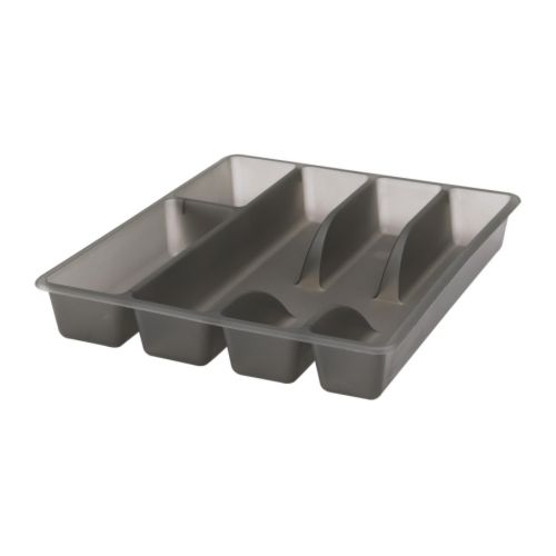

Back to the Alex. Good view of assembly here:
I'll assemble dry first and then when all finally tested and fitted it will be reassembled with PU glued joints and some more reinforcement - essential to keep any Ikea furniture solid for years to come. Any exposed edges of board will be sealed.
Pretty amazing what you can fit into this thing - everything you see here and more will go in, including some 2 litre water bottles in the bottom, basically our entire kitchen/cooking/eating set up for four:
