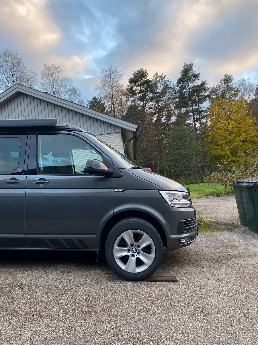

Since I sold our BMW 520D almost two years ago I have tried selling our BMW winter wheels. Not a serious answer.
I have found out that these rims will fit on our California. Obviously the tires are wrong so I will change to our existing tires on the steel rims. Any issues? I will most likely spray paint them matte black with plastidip.
What is the load rating on those rims?
They won’t have the required load rating. I’m in the same boat, have some left over RFT in the correct size on rims, but neither the wheel or the tyre are rated high enough to use with the van.
So they might fit and be work fine, but you could run into legality issues should anything go wrong.
Are they from an X5 ?
Tyre load ratings on an X5 go from 105 upwards which would lead me
to think that any car with a tyre rating higher than a Cali should
be okay, weight wise.
No BMW car, estate or otherwise, are suitable for VW T range due to insufficient load rating.
4x4 X5 wheels may be but ---
There could be both Insurance and legal implications as they are not designed for a commercial vehicle or a VW.
Legally you get into Construction and Use regulations which in the event of an accident (not necessarily your fault) the Police may home in on these as could the DVSA.
There are vans running around with these on but I wouldn't.
