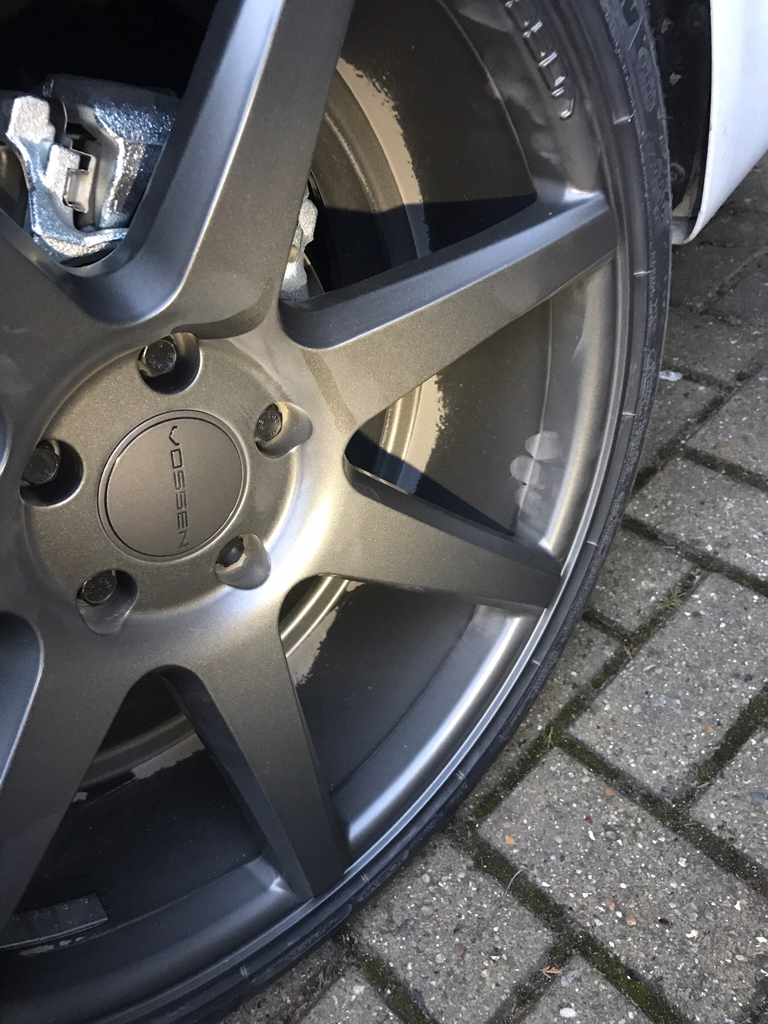

Hi all. Fitted new wheels and tyres. After 80 motorway miles the rear wheels only are covered in a dust the consistency of flour. Nothing on the fronts. Just the rears. There’s no rubbing anywhere etc. Are the rears more prone to dust than the fronts?
You can see where the ‘metallic’ dust has adhered to the tyre fitter’s hand prints.

Not in my experience. But that doesn’t look like brake dust.
No, you’re right, it doesn’t. It’s bothering me though as I don’t know why it’s just on the rear wheels or where it’s come from.
Have the roads been salted or were you driving near a quarry/construction site - it looks like either salt or clay dust.
Yes it’s very very fine. Like clay dust I suppose. Maybe I’m worrying unnecessarily, I’m always checking for potential issues after fitting new stuff and it struck me as odd that the front wheels are clean as a whistle. They were only fitted yesterday afternoon.

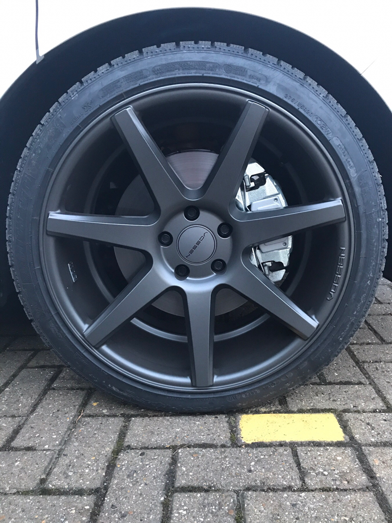

Clean fronts:

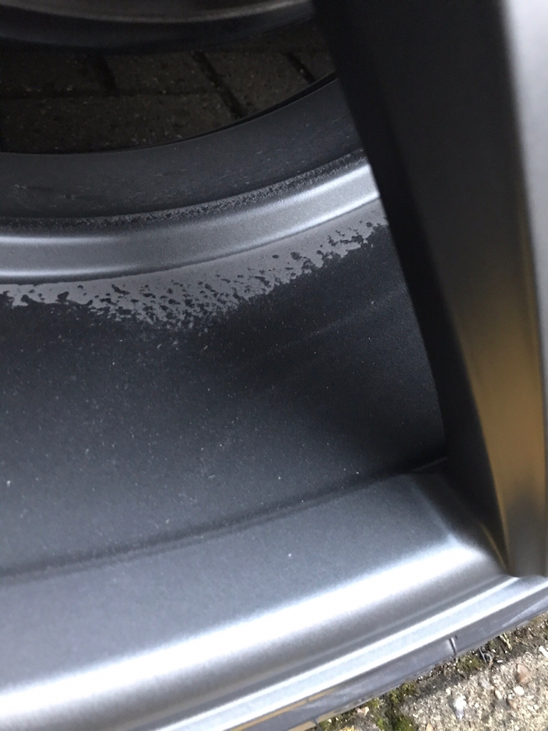

What does concern me though is the bad etching of the alloy highlighted here.

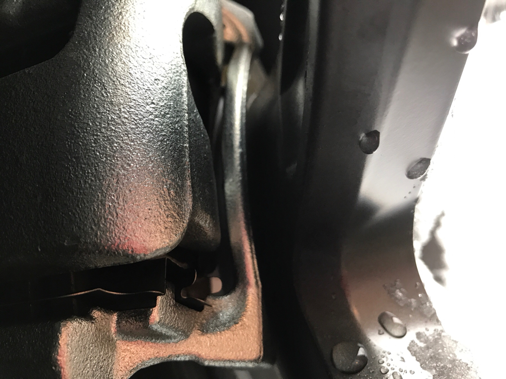

Hi guys, I’ve can see the spokes are nowhere near the calipers or anything at all - I can get my hand in there and feel the back of the spokes which are clean and smooth. I got under the van and checked the insides of the rims and the tyres to make sure nothing was touching and the tyres are unmarked. The wheels are Vossen CV7 10x20 et45 and I know that plenty of people have put 10.5x20 on the rears without issues and with TUV approval etc. I’m hoping it’s just clay dust from a puddle I reversed into.... What looks like scoring on the wheel isn’t scoring, it’s just where the dust has landed and wipes off clean. The car was driven with hardly any weight in too.
Big gap between wheel and calipers/hub. And about a fingers width on the inside of the rim to the plastic wheel well liner - neither rim, tyre or liner seem to be compromised in any way. Will see what transpires and maybe go with a 5mm spacer for peace of mind. Really appreciate all of your feedback, said it before and will say it again - love this place!

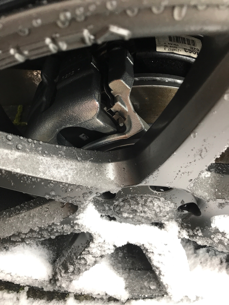

Hi, thanks for asking - no, not yet as it was dumping snow yesterday and P-ing down today so it was washed last night ready to see if anything else appears.
There were no adverse noises en route back (or any other time) and I’m inspecting everything (again) with an endoscope tonight when I get home. Living the dream - my winter evenings just fly by!
