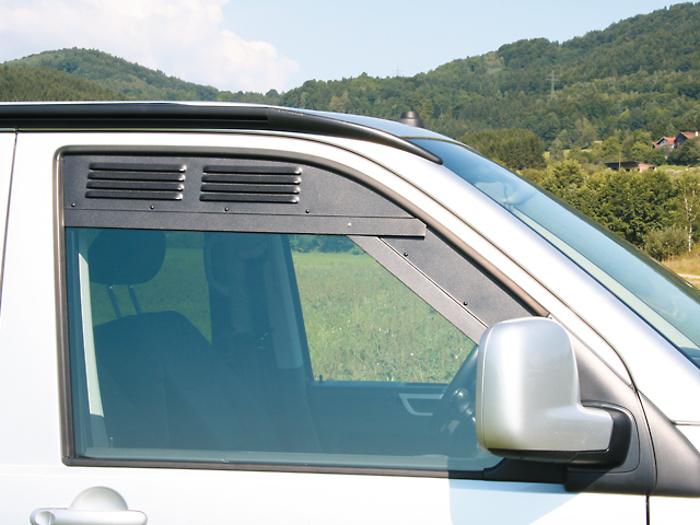

Has anyone that has got these vents that can give me a honest opinion on how effective they are as in how much air passes through them, and how much hassle they are to fit? plus how secure they actually are from security point of view
I've got them on my T4 Multivan.
Great bits of kit... mine fit in seconds, really is as easy as winding the window up once you get the knack of positioning them first.
Secure... being metal and locked in place I treat it as if the windows are fully up. Happy to leave it parked etc.
A reasonable amount of ventilation but not a massive flow through.
Certainly made a difference to the amount of condensation in the van.
Hope this helps,

Thanks Mark, we are off to Spain again this year and we have a Air-safe for the tailgate and I would put the blinds down, roof up and open the zip windows etc just looking at more air flow but being as secure as possible.
I'm wondering what would be worst having the Silverscreen and no vent or the Brandrup vent and windscreen glare.
Then I was thinking about the Dubflecta's but not sure how secure they would be.. I guess these could be used along side the silverscreen so wouldn't stand out to a opportunist, the air flow would be minimal but its something.
Decisions Decisions :Nailbiting
I also got the airvents and find them pretty good , once you get the trick of putting them in , hold in position with one hand and pushing the window-up button by other hand ...carefully closing the last cm. There is a "automatic go back down " funtion on the window ( at least on my 2012 SE) that prevents sqashing a finger or so if something gets in the way....so the final closingpoint need to be searched.
I think i gives good airflow and holds out rain ( not by storm ...)
Worth the money!
What about deflectors? (Edited: some messages came in the mean time I was writing this :D)
Deflectors work fine to allow ventilation but they are not secure. These window vents mean the care has ventilation and the vehicle is as secure as it is with the windows closed.
Yes, that's the cons of dedlectors
Ok one last silly question.. Has any one tried to fit the Brandrup Vent and Dubflectors at the same time?
Not on a T5 but I've got both on the T4, works fine.
