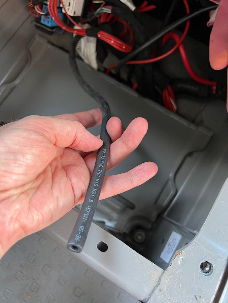

I’m right in the middle of replacing the batteries today but the k3yak guide doesn’t include a picture of the breather pipe for the front battery.
I found this lying loose. Is this it?
Thanks
My wife helped me fit the batteries and she thinks black from memory. If it is the breather it will already be fitted to the old battery, in which case just remove the little bung and stuff it in
Just realised I am sitting above the from battery! this is how it should look……
Thanks for your help but, as you can see from my photo, it’s not fitted to anything . It was after I removed the battery from the compartment that I found this tube lying on the floor.
I could see that the old battery breather hole had a small L shaped connector tube still lodged in it. So, I suspect this rubber hose (in my hand) is the breather tube and it has just come loose when I was wrestling that stubborn rubber jacket off the battery.
The reason I was unsure is that the breather tube on the rear battery is a 6mm diameter corrugated plastic hose, which looks very different to this thicker foam rubber tubing.
I have just fitted it on to the little L shaped pipe and the job is now done. I trust that if I have made a drastic error here someone will jump in and let me know.
Thanks
