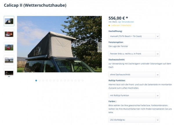

Hi Bart and Marga This is very helpful, thank you. I am planning on travelling in the colder (and wetter) months to Scotland and Europe. I have read somewhere that the roof canvas can get very wet and leak. Can you tell me the make of the German topper you refer to? As far as I am concerned the easier and more weather proof the better.
You can get it in the shop of the german Cali-club, the sister org of this club here. Also, their cloth seems to be a more advanced cloth, with less inside condensation as the Comfortz' topper we have.
