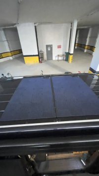

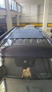

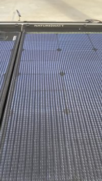

State-of-the-art solar power kit for your VW California campervan. Naturewatt output power up to 450wp. Powerful efficiency even in diffused light. No need to turn your vehicle towards the sun. Wattstunde high-end solar module, Victron solar charger, model-specific wiring harness. Application-controlled. Weather-resistant. Developed and manufactured by automotive engineers to the highest quality standards. Low-profile roof structure, easy installation. No drilling or gluing, installation without damaging the vehicle's original design. Expandable up to three modules.
naturewat.de

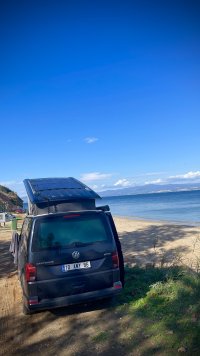

Nice looking kit, not cheap, interested if ship to UK, as outside EU.
Sanırım AB dışına gönderim yapıyorlar. Evet, diğer şirketlere kıyasla ucuz değil ama bence çok kaliteli, şık görünümlü ve iyi konumlandırılmış bir mühendislik harikası. Tavsiye ederim, çok memnun kalacaksınız. ☺️
Did you buy and install this on your van? Or is this an ad?
What’s the additional height added by the panel attachment?

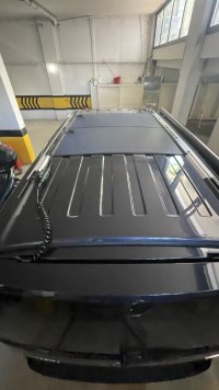

If you look at the pictures on their website you'll see that the installed panel is still lower than the highest point of the wind out awning. This is pretty much the case with most solar installs (including my own diy install that might not look as neat as NatureWatt's one but was a third of the price).
Is the curly wurly cable available on its own?
Bunu satın alıp aracınıza mı taktırdınız? Yoksa bu bir reklam mı?
Panel eklentisi ile eklenen ilave yükseklik Yes, I installed it. It's not like the panel has any additional height.
