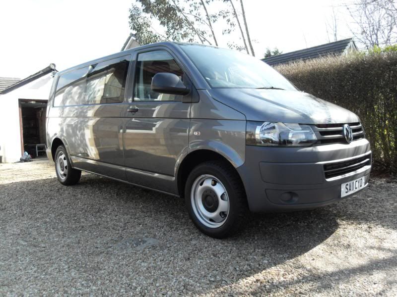

But you can also pick up sets with the 17" steels shown by Sandyvan for about £500 (New heels, new tyres.. Well 2 miles). I got a set myself.
