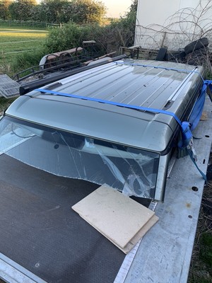

Hi Helen. You're not the first person to debate doing this and I'm sure there was a recent post about the subject. There was mention of Kernow Campers carrying out a conversion on a Caravelle using a genuine VW PopTop and all VW parts.
We're thinking of putting a pop up on our 2013 Caravelle. Are we crazy?
Makes sense.
Van prices are crazy and you can convert into a Beach style van for a little investment.
Go for it…:thumb
No Crazy
it can be done with all OEM parts - here is one thread, there are others (use the search function top right)
keep us informed pls
Someone posted a pic of a Transporter with Cali roof, rails & seat on the T6 forum recently. Can definitely be done.
