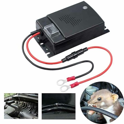

I've got one of this type fitted - no way to know if working other than getting rodent damage in future to show that it doesn't.
Thank you.
Where would you connect to please.
Looks good.
Thank you.
Looks good.
Simply connected to battery + terminal and body frame for earth. screw on wing inner between battery and headlight.
Did have to fit extended power wires in order to fit in engine bay, originals are a bit short.
No battery drain issue after parking for 4 weeks with engine starting.
