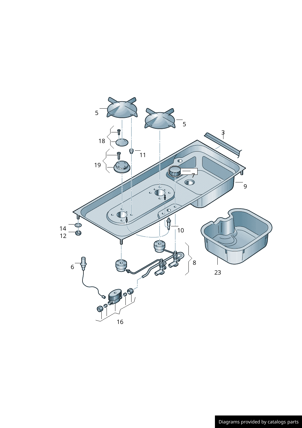

I ordered up some sockets and took a look at this at the weekend. How simple is it to remove the cooker / sink top? Plumbing side for the water / drainage looks straight forward enough but the gas all looks to be hard piped? Does anyone have any experience on doing this?
The circle cut outs in the unit carcass give access to nuts which look to hold the sink / cooker unit in place.
Would it be easier to take a multi-tool to the underside of the carcass, trim it a couple of locations back to create additional room for access to the rear of the sockets? View attachment 132468View attachment 132469
You would just have to disconnect the gas at No 16 on the diagram below.
But your idea has merit and would avoid dismantling the sink/cooker and any damage.
Thanks for the image. As I thought, would need to take a part a section of the gas pipework. Think i will tackle it with the multitool and see how I get on :Nailbiting
