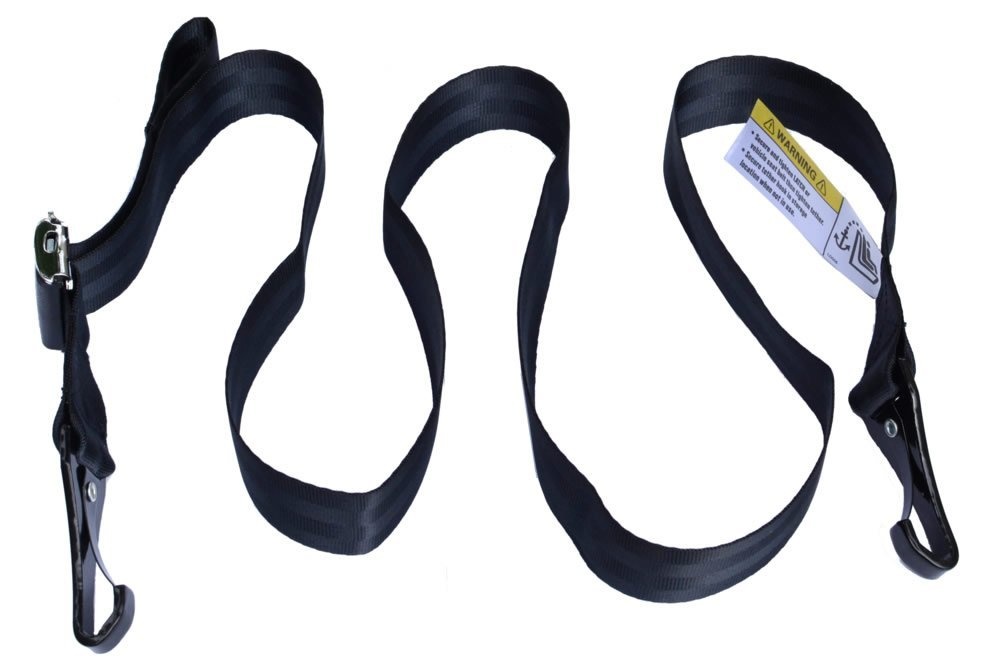

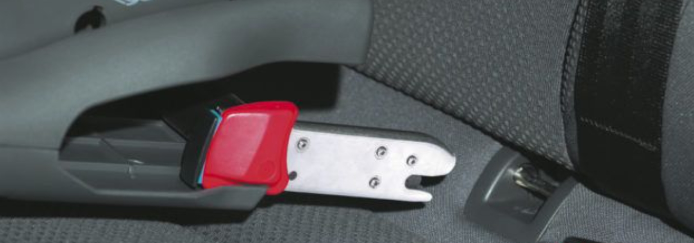

If the isofix-hooks in the bench seat of the T6.1 are similair to the ones in the T5.1, you might want to know the following: Seats with 'rods' (photo 1) are incredibly hard to get through the opening between the seat and the backrest. Seats with straps & hooks (photo 2) are much much easier to place and remove. While not a huge problem when it's just for the occasional drive, it is really a pain when camping. But perhaps VW made the isofix-connections in the bench more accesable in the T6.1 model.
It’s easier fitting the “ rods “ if you pull the seat forward 6 inches and then pull the strap to recline the seat back slightly. Once fitted in place pull the strap to return the seat back to the upright position and slide the seat backwards.

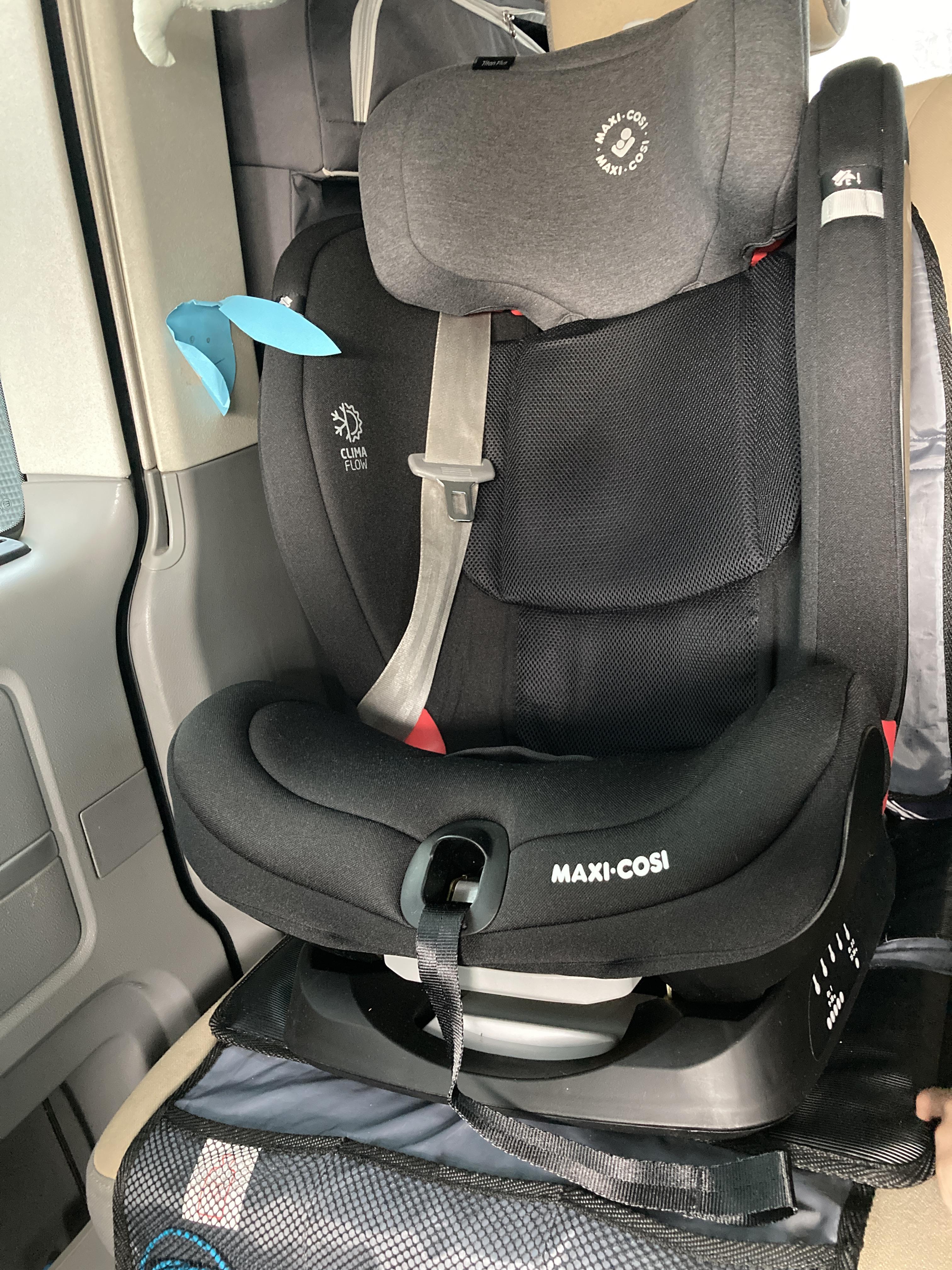

We use several child chairs and seats: a set in my wife's car and a set in the California. We previously had the base of maxi cosi and this had a leg and you could click in a maxi cosi carrier (for babies). Later we bought other child seats when they got bigger: amongst Britax (with extra leg) and also one of which you can detach the backrest so that when they are bigger you only have a booster seat but with iso fix.
We just switched from a Maxi Cosi Family Fix base seat to a Maxi Cosi Titan +.
Big plus for us: no leg and we can use the seat in cars/motorhomes with no ISOFIX.
