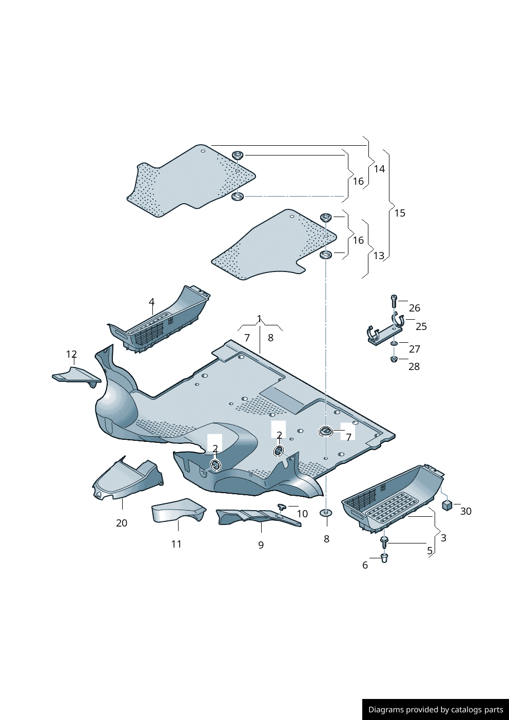

How do you wire from front seat to door step, any hint please. Because I want to hide it make it factory look ;p
In that case you’ll either have to remove seat base to get under the carpet or take wiring out of seat base rear and along the carpet edge to base of B pillar then forward under edge of step trim.
