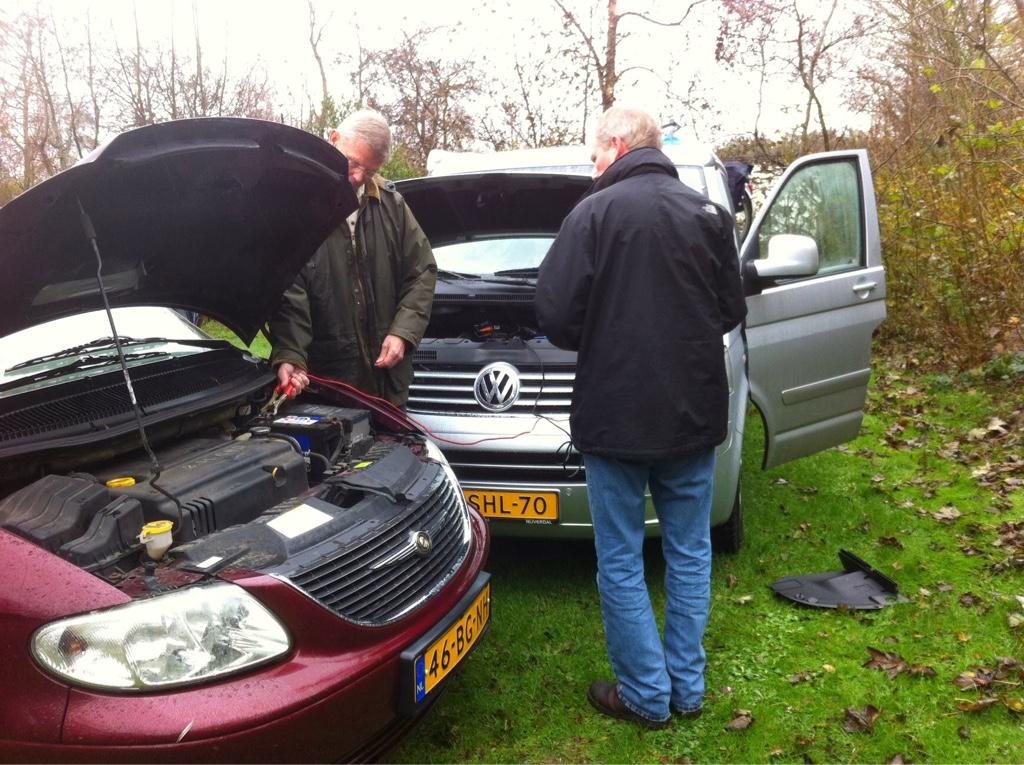

starter cables and a friendly Frenchman would have done the trick quickly and cheap. Been there...
Verzonden vanaf mijn iPhone met Tapatalk
Who's starting Who?
A frienly frenchman with a Dutch plate ? ;)
