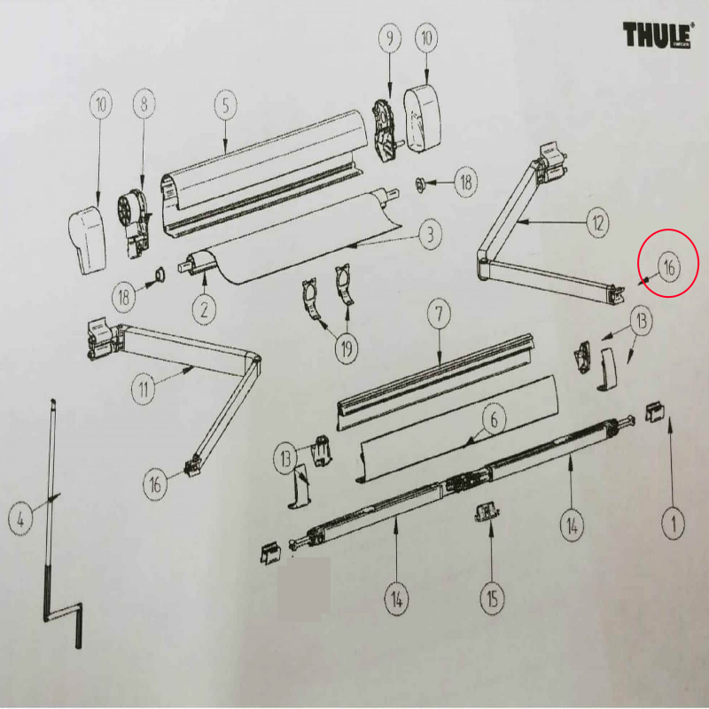

Just had a look on the shop site, wondering if this is the part?
I think you will find that parts 15 & 16 are the slider clamps onto the front awning case. Not the alloy cast joint that fits into the end of the arm that is probably a push fit and impossible to remove. I could be wrong so you need to check carefully.
Contact Thule to confirm, but looking at that parts diagram you are looking at complete arm assemblies unfortunately. That said the diagram is specific to the VW awning but Thule may use the same parts on other models, which may have a different spares schedule. Contact Thule.

Looks like you are right after talking to a few online stores.
Yeah, not a bad idea, maybe they will sell separately if i go direct.

Thanks, I just popped in to seem him, real helpful guy be he also said that I need to buy the whole arm.
Now my options are to buy two arms (when I only need the brackets) which comes to over £400 or find someone that can weld this back together or find someone that can make me a new bracket.

Just checking,
I thought the brackets on the casing end were available as separate items, but this might have changed - this site is saying not available - just used this site as it has a picture
100602754
100602754
Yes I just found these on another site but its in Italy. Need this by Tuesday, so not ideal.
That could be worth a look, looks like a different product code but it looks the same as the one on the 5102
There are subtle differences and its a friction fit so I would go with an original part for the 5102 unless Thule say otherwise. Have you contacted Thule UK (800) 238-2388
I think part of the confusion is that there are two different parts listed against item 16 on the diagram
The top one is a pair of brackets for the rail, the lower part number is for a pair of the arm end brackets
So 16 is pointing to the combined joint, but you can buy both elements
I would call Rose Awnings and just ask if they can order it, they list only the upper part number, but that might just be an oversight and they haven't spotted this
