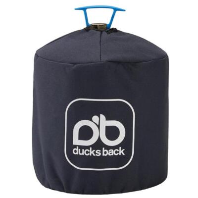

Would this help? I have the Campingaz cover on my spare - purely to stop it doing any damage when in the boot, but you cant find them anywhere now. Just wondered if this would help with insulation? Assuming it still fits in the locker with it on of course?
When your cooker is running butane (or propane or a mix) is evaporating inside the cylinder which reduces the temperature of the remaining liquid. The bottle will absorb heat from its surroundings and an equilibrium will eventually be established.
Insulating the bottle may raise the bottle starting temperature but will reduce the equilibrium temperature. Below a certain equilibrium temperature cooker performance will degrade and eventually stop.
As with all of these things a good experimental setup might reveal surprises but my gut feel is that the insulation will not be helpful.
