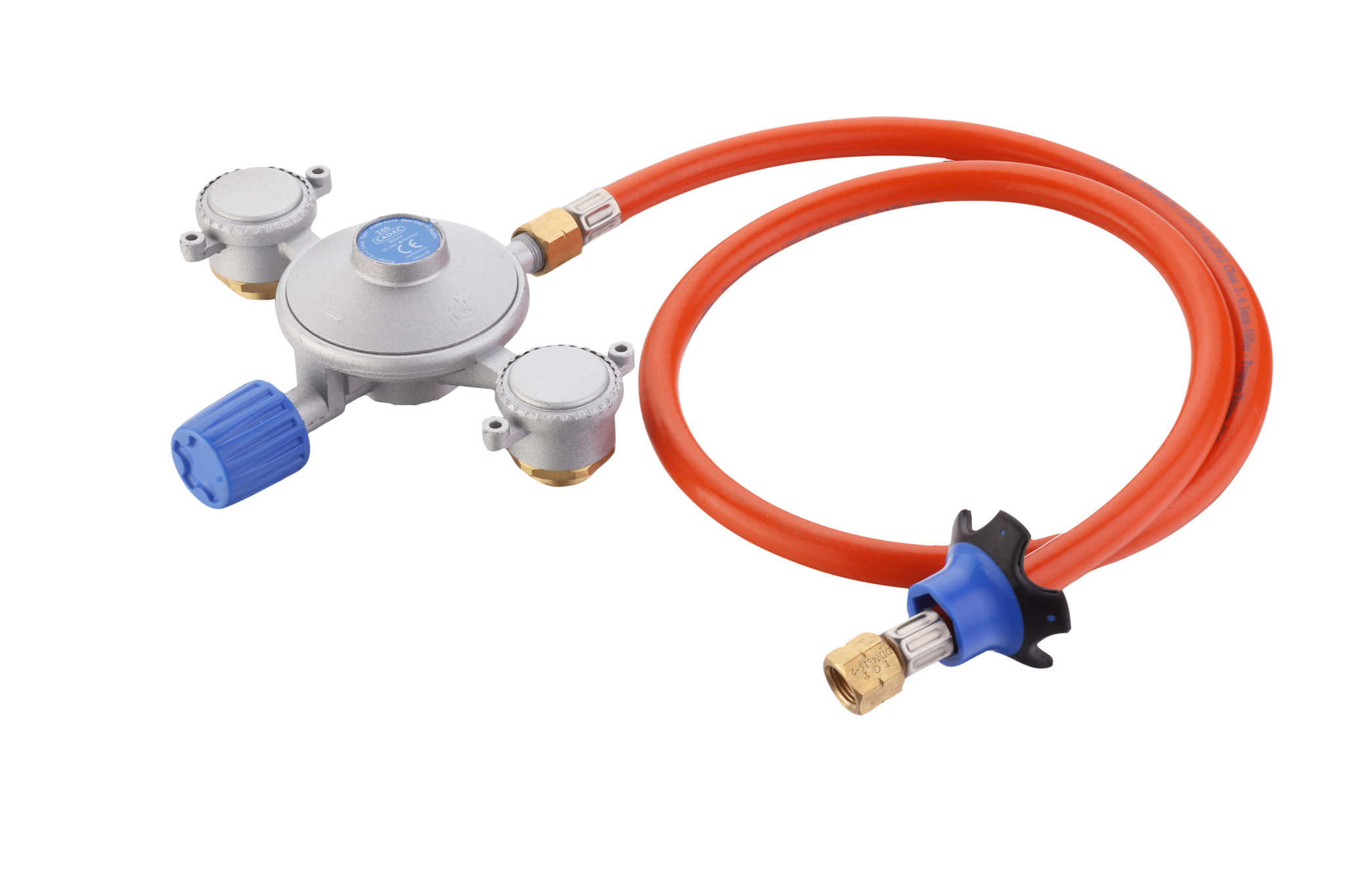

If you want mixed gas then look at a cadac dual Pak. Mixed gases separate when stood hence "shaking"
Yes good idea , Primus Iso Butane Power RED Disposable Gas can be used with Cadac Dual Pak , regular an hose just found out

All types of camping gas use a 37mbar regulator, it is the gas fittings that are different for each proprietors bottles. I would fit a quick release fitting to the van and then have tails with regulator(s) to bottles, so a cadac dual pak could replace the 907 quickly and safely.

I have the Cadac Carri Chef 40. I had planned to buy the Cadac 343 hose and (29mbar) regulator to use with my current 500g gas cartridges.
However, it seems daft taking two lots of different gas out.
I know the Cali takes 907 gas but I don't know what the connection type on these looks like so just wondered if it was possible to use the the 907 gas on the Cadac by buying the right regulator.

The cadac dual pak has a regulator built in and a shut off valve, so yes it could replace your camping Gaz 907 California regulator, the middle link above is for a 907 bottle mounted regulator with shut off valve. The quick release connectors would make it easier to change between different gas types

OK, so get the Cadac dual pack to run the Cadac, get the quick release connector and then use that from the Cadac adapter to the Cali hose?
I've just found this post
https://vwcaliforniaclub.com/thread...r-to-fit-in-place-of-butane.47297/post-615439
But can't find the one they are referring too.
That said, I think I get it now....
Remove Cali Regulator from hose
Connect a quick connect adapter (first link above) to Cali Hose
Then have a Cadac adapter (bottom link) that quick connects to that with two bottles of gas on, or can also be used with the Cadac.
And also have a Campingaz Regulator & Hose with quick adapter - again being able to use that in the Cali or take out to use on the Cadac.
So can go big or small gas.
Right?
