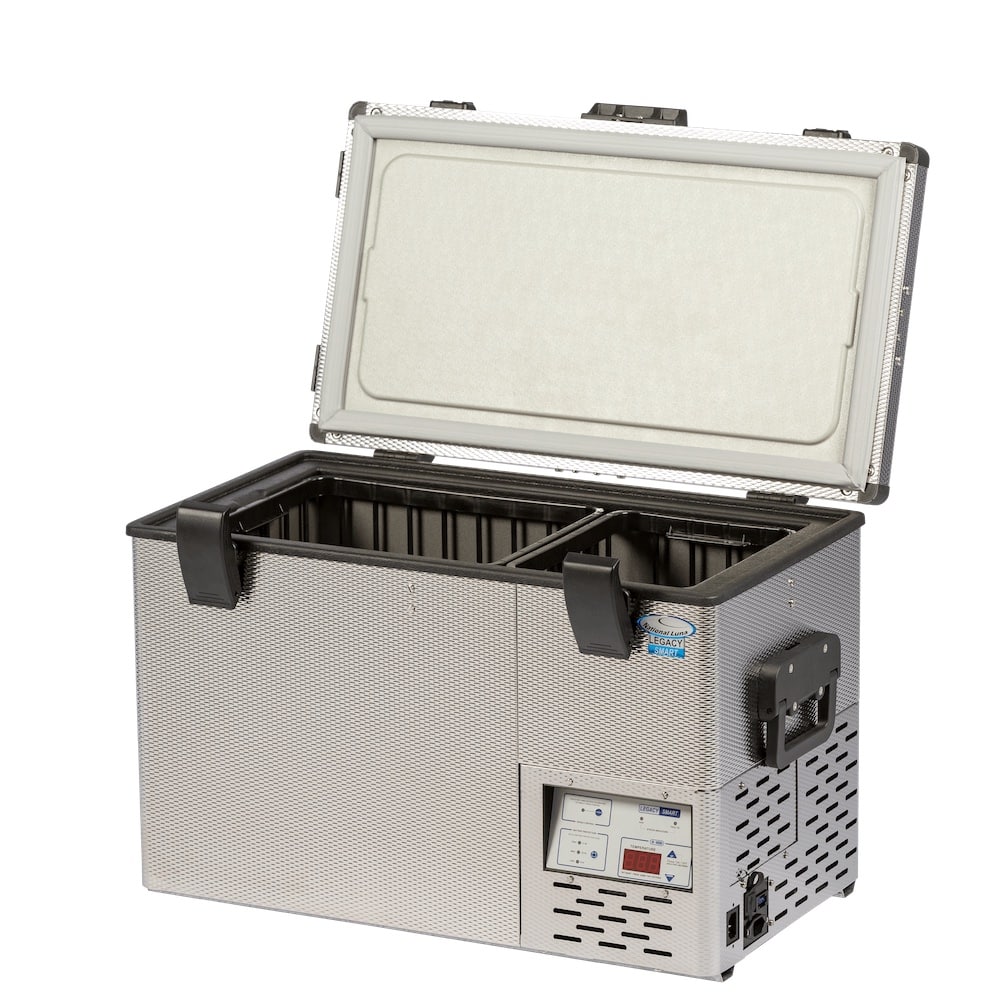

I know it's not used but have you looked at the smaller capacity fridge/freezer from National Luna. They're built to last with a good compressor warranty.
Thanks, looks good. Similar price to Dometic.
