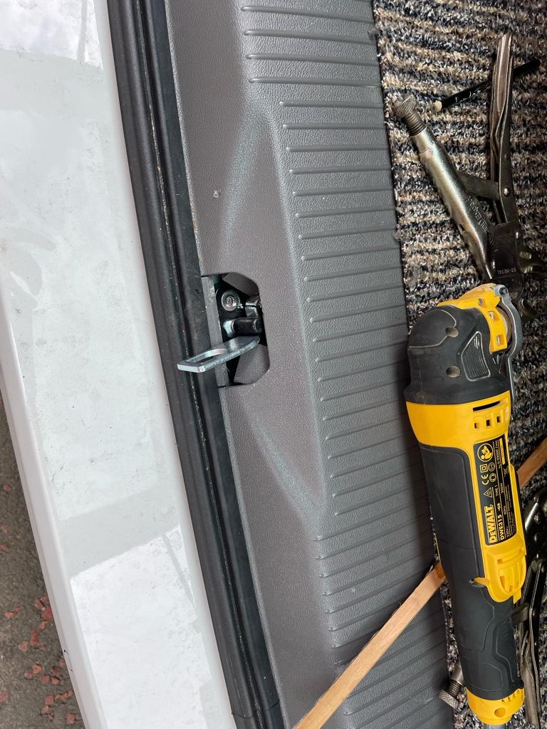

I’ve just managed to jam one of these in my T6.1 Coast tailgate lock and have just finished cutting it off…… While this forum often has great advice on it of how to do things here a cautionary post of something to avoid!

I just had one get stuck in my 6.1 electric helper tailgate lock. I tried what he does in the video above, but had no luck. However, I found an easier option than using a power tool to cut the steel itself.
I removed the plastic covers surrounding the locking mechanism.
The top layer can be pried off starting from the inside using your fingers - with a bit of force, it pops off. The second layer of plastic is held in place by four Phillips head screws. It's very easy to remove: just unscrew them and lift off the entire plastic piece. Once that's done, the locking mechanism is fully exposed, and the tailgate latch is super easy to remove.
After that, just reverse the process to put everything back together. Be mindful of the soft rubber trim and make sure it goes back exactly as it was when you removed it.
I am not putting that thing it there again... was a bit nervous before I figured out how to get it out...
