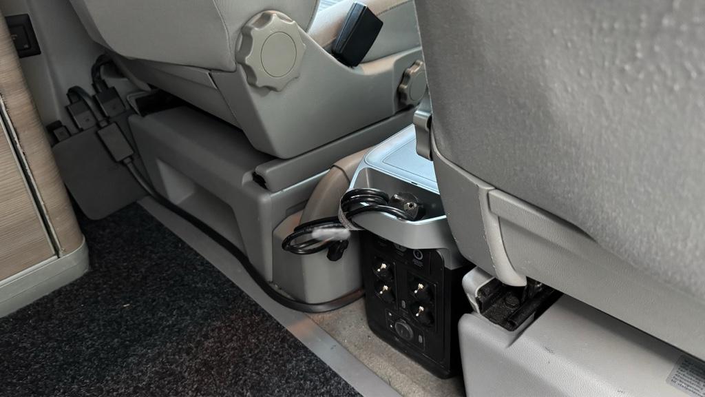

I think depends if you want maximum charging efficiency. Some connect to a leisure battery, others to the alternator feed under the lefthand seat (best).

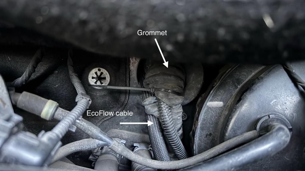

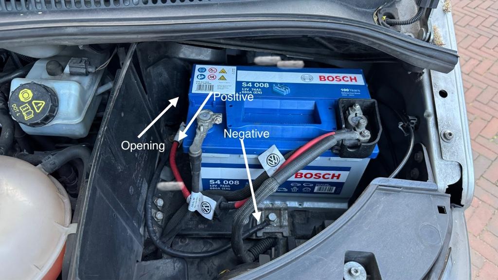

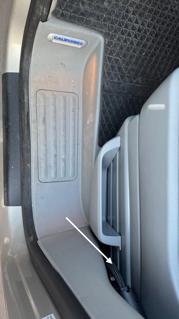

I installed the 800w alternator charger (originally bought for another car that I no longer own) to the starter battery.
I have a left hand drive Transporter (2013) that was converted to a full California Ocean interior by a previous owner.

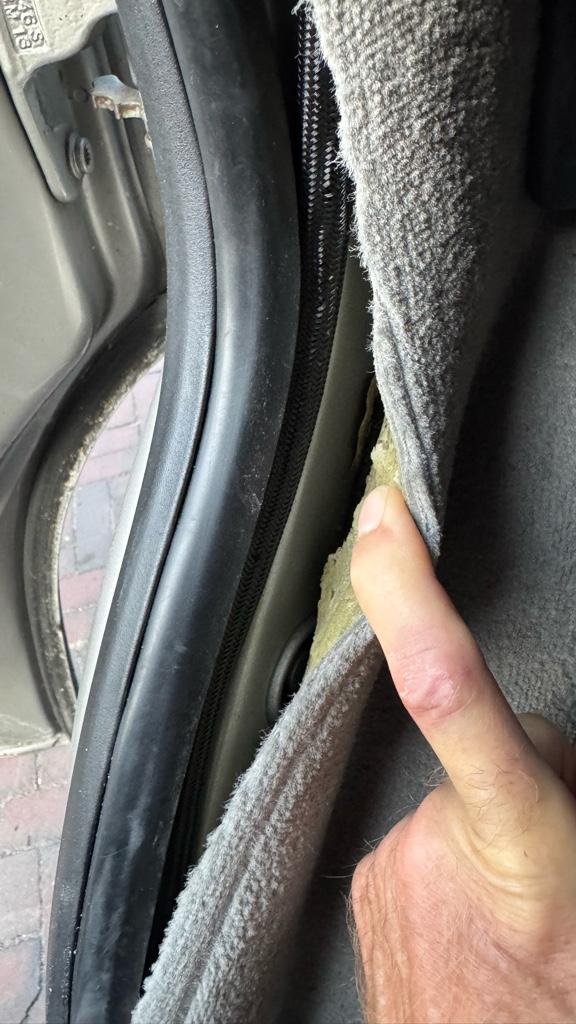

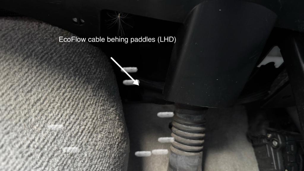

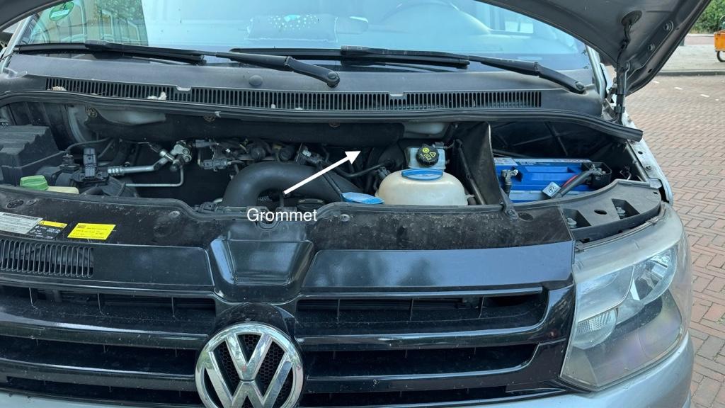

Found a grommet in the middle of the engine bay, more or less behind the middle console (where the shifter is). I used that to route the cable to the inside, then to the left behind the paddles (for a RHD it would be passenger side). Then down across the wheel arch behind the interior clothing.
Removed the side step (clips) and tucked away the EcoFlow thick cable (with a bend), then resurfaced just behind it.
I hope the pictures make it clear. If not, ask me.

It’s a bit of fiddling as the cable is a bit long. Part of it is curled up behind the starter battery, part is curled up under the side stepping board.
I also had to cut a hole in the grommet to feed it through the firewall to the inside, not sure if it remains all water proof that way, but till now I have had any issues and don’t plan to swim with the Cali .
It may be not the nicest and cleanest way to do it, but it works for me.
I hope it can be done the same way on a RHD.
