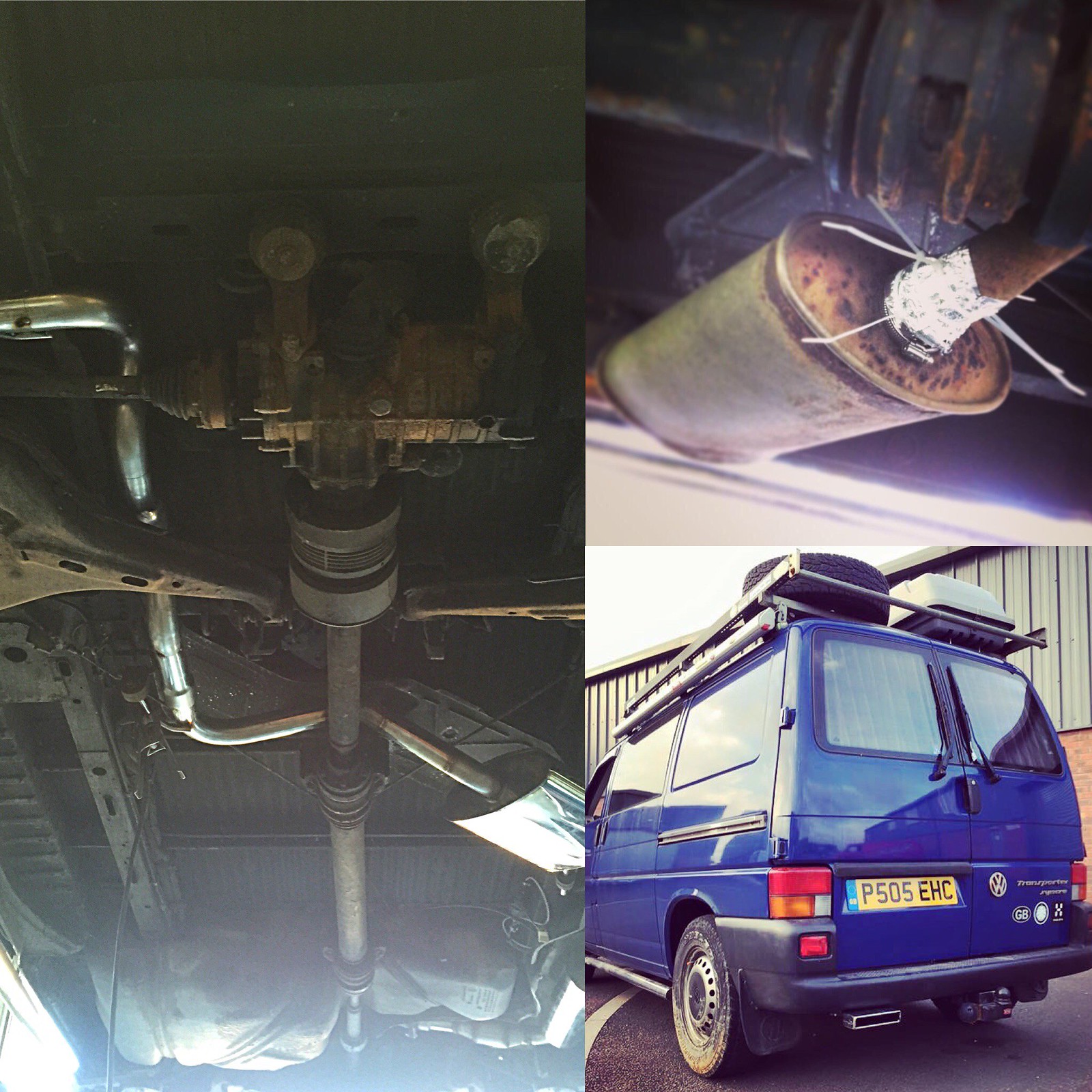

I can't recommend Jason at PPTuning enough. Top bloke! I let him have my 2.4D Syncro for a few months and he made up a whole new system from scratch and he also made a jig too to make a load more due to the complex run involved. Its gave the 2.4D a new lease of life and I goes and sounds like it should!
Untitled by Matt Wilde, on Flickr
Very smart Matt..
