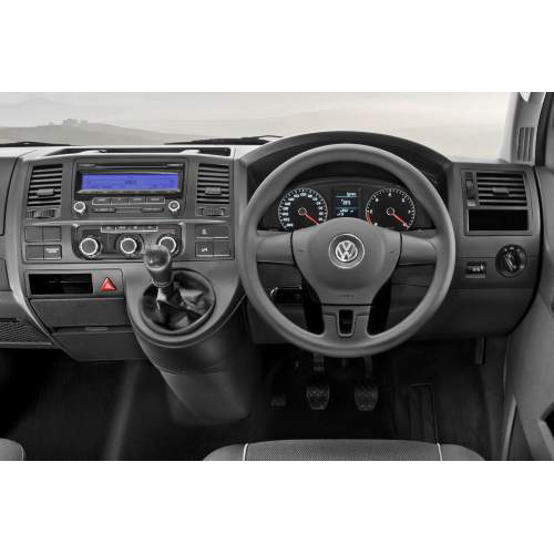

Hi everyone,
We have a T5, I believe it is a174bhp TDI SE, the predecessor to the Ocean. I stand to be corrected.
I would like to upgrade my current head unit, a Sony, to An RNS 510, which I have already purchased.
I know I can get a facia replacement which will accommodate the unit.
The problem I have is, the replacement is for a newer model which has the heating/electric seats controls located together, whereas, My vehicle has separate controls for the heated seats.
Is anyone able to point me in the right direction for a workaround or advice.
Thanks in advance.

The square cornered ins 510 might fit if you can cut out the rest
of the plastic as long as there are no metal pieces behind.
Can you just leave the wires out for the heated seats or does it not
work like that
You have a normal double DIN dashboard.
Do you have a scrwed in and slightly curved RNS510 or the Multivan clicked in RNS510?
The Multivan one is much larger, and equals the T5 Multivan dashboard.
Hi Triplebee,
It's the slightly curved screw in version I have.
It may be that with a careful bit of cutting and fettling it could be made to fit without looking too awful.
Does anyone on this thread know how to go about removing the existing facia without damaging it ?
work like that
Hi Westfalia,
I wish I knew what was possible.
If I could figure out how to remove the existing facia without damage I would have a go, but until I have some idea if that's possible,I'm a bit loath to do so.
This might help, i know its a different dash but removing the fascia
is the same.
is the same.
Thanks very much Westfalia.
That certainly gives me a good idea of how to remove.
I don't feel so intimidated to have a go now.
If your dash has the screw points, or at least you could put the radio in, and fix it, you can try to paper draw the contours of the radio and cut that out in paper. Place it over the facia, and dremel it out?
Let us know how it goes.
