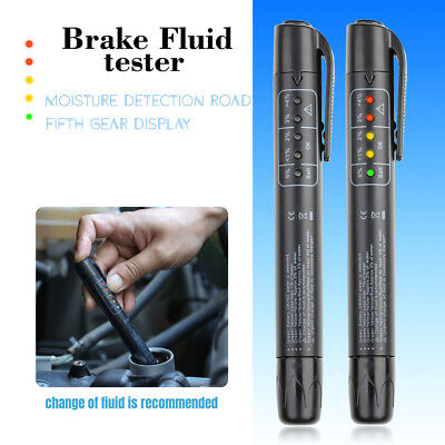

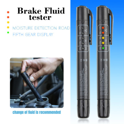

Problem with brake fluid is that it is hydroscopic and modern vehicles with ABS are prone to the ABS unit being damaged by the water content hence need for regular fluid changes.
You may have a faulty brake system that merely changing the fluid will not remedy. Could get very costly if unlucky.
Brake fluid testers are relatively cheap from this low level cost upwards
