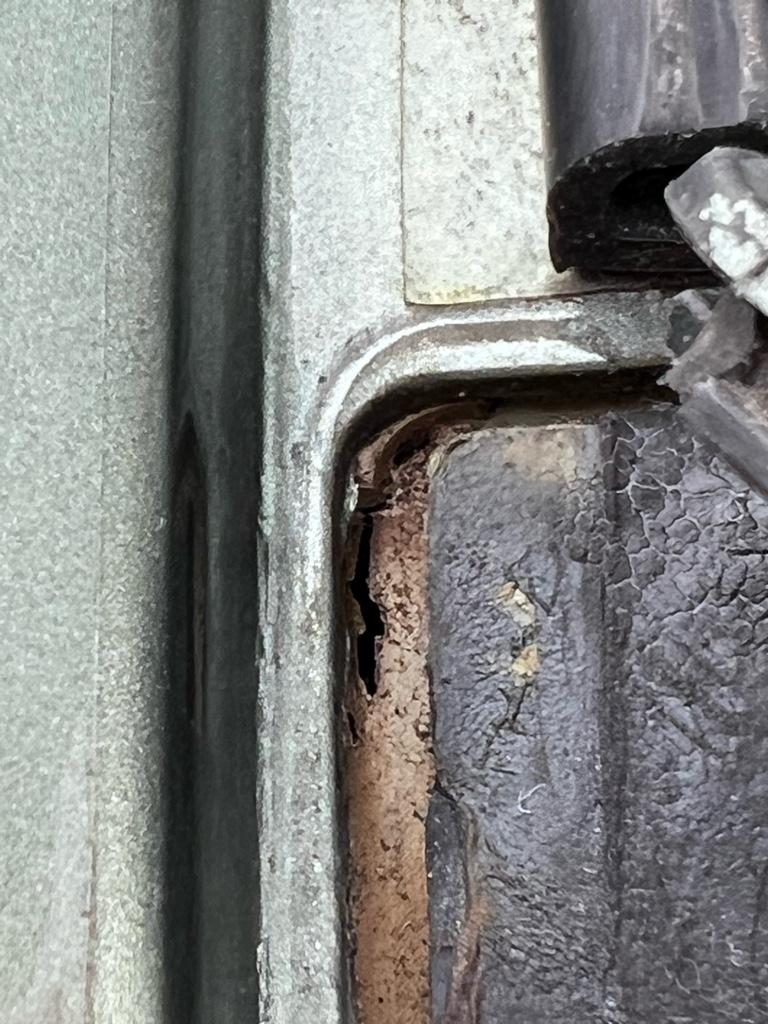

Front left side is leaking (door or roof)
Thank you! I will give it a go after I do several water tests with garage’s sealant fix.
Do you know anything about roof corrosion? What this could be and what issues this could cause.
I’m just trying to trace this leakage. It’s coming from different location now. However, the car is parked on the slope, front left at the lowest point and is difficult to say where the water is coming from.
I’m thinking about removing a headliner to see what’s happening there. Any instructions how to remove it next to the control unit and around the sliding panel above the head?
Thanks, Jev

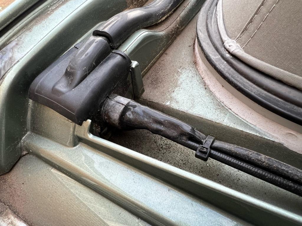

you might be right in that headlining removal is a good call at this point. I wonder whether those rubber grommets are intended to be bonded in place permanantly & yours has now been disturbed.
might they be fitted at factory and then bonded in place internally to guarantee a 100% seal? Once disturbed it might just need bonding back carefully.

I recently removed a roof rack from my Golf after several years. It was bolted securely with rubber bushes protecting the bodywork. Only that’s not what had happened. Under the rubber the paint was worn through and even the steel seemed worn down. The rubber protection had actually damaged the roof. Perhaps that’s what happened to your roof? The constant flexing over many years maybe worn a hole? Perhaps aluminium is softer than steel. It might not be corrosion.

Just got our van (T5, 2.0 TDI, 2012) recently and when cleaning it with pressure washer I noticed both A pillars and the area around the grab handles inside the van got wet. It hasn't rained heavily since we got the van, but I suspect the problem is related to the angle and pressure of the pressure washer.
After reading this thread I check both front drain holes and the water runs down beautifully over the front tires. Rubber parts seem to be in working condition.
I did notice a gap between the part that is about the windshield and the chassi (?). I borrowed mr_waxdope_noodle's photo to demonstrate. There's a gap (I can push from the top to eliminate it) on both sides, but not in the middle.
I suspect that's where the water came in. I put some tape for now but thinking of sealing it either with Sika or epoxy.
Anyone else had this issue? Any recommendations?

Has the vehicle had the VW repair for the problem of galvanic corrosion affecting the roof cap above the windscreen? This involved sticking a plastic colour coded cap over the metal, after removing and treating the corrosion. There have been many reports of these caps coming loose and leaking.

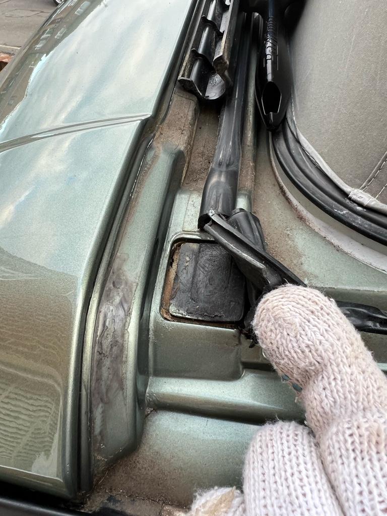

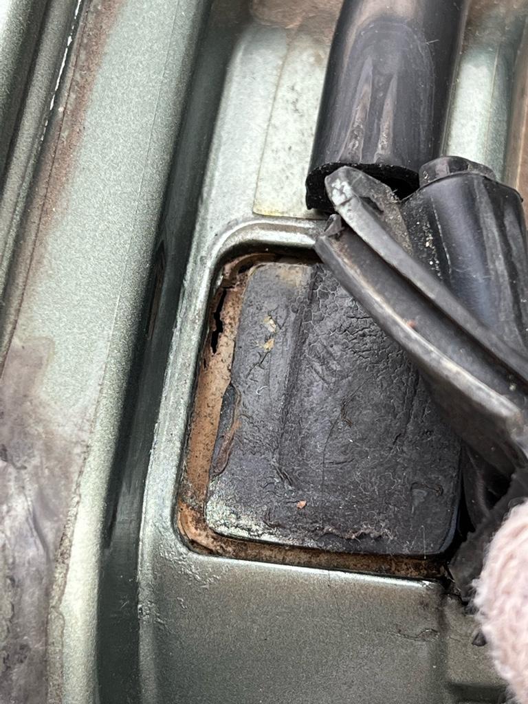

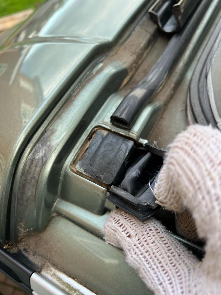

Hey WelshGas, thanks for the reply. I wish I knew about this issue before dropping 35k+ on a T5. Now I'm semi freaking out. I've attached some photos, what's your take on this? At least I don't see any corrosion on neither side of the roof cap. Thanks again
Maybe very carefully clean it with toothbrush and cloths then seal as you suggested. It does look like a plastic cap. It does look in ok condition.
No more pressure washing and you could be fine.
Get it cleaned up properly avoiding water entering the gaps where possible , degrease and re seal.
have a look at Sika products there is a large range of sealant / adhesive specifically for motor home / caravan / outside application.
to allow you to get the best finish possible on the new sealant , you could try this type of tool(s) they work really well in smoothing and pressing sealant into the crevices, they remove excess material as you use them.
there are videos online that will assist in the correct use of the tools.
the image is from screwfix
That is the plastic cap. Underneath is the original structural aluminium alloy roof cap. Galvanic corrosion is cosmetic not structural.
As above detailed by @Perfectos clean and reseal.
If you want confirmation of the warranty repair then any VW commercial dealer should be able to give you a printout of the electronic service record based on the vehicle VIN.
Maybe worth considering cutting off the rubber trims at the end of the awning rail to check you dont have corrosion underneath them, the sealant between those trims and the plastic cap looks like stevie wonder applied it and suggests either they weren't removed before the cap was fitted (stupid move) or someone is looking to hide something. Clean all old sealant off, knife or toffee wheel, ipa wipe down and reseal. UV stable sika, maybe with adhesion promoter. Wipe down with tool/finger wet with meths gets a good finish but not too much else you compromise the adhesion.

That should be fine just make sure you read the product data sheet for application and cleaning off as Sikaflex can be a pain to use, worth masking up surrounding areas and getting a set of silicone spreaders for a neat job.
When I was searching for my roof leak I managed to drop the roof liner in one corner (above the sun visor and door) and get a borescope into the cavity under the cap. Might be worth having a look to confirm that the seal is the culprit.

You need silkaflex remover, only works before the silkaflex has cured. Mask area well, re-stick trim with silkaflex, remove masking tape whilst it’s still wet & wipe any excess off with the silkaflex remover / kitchen roll, then you can right up to the edge.

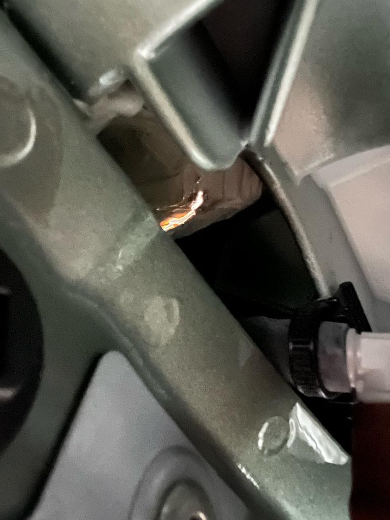

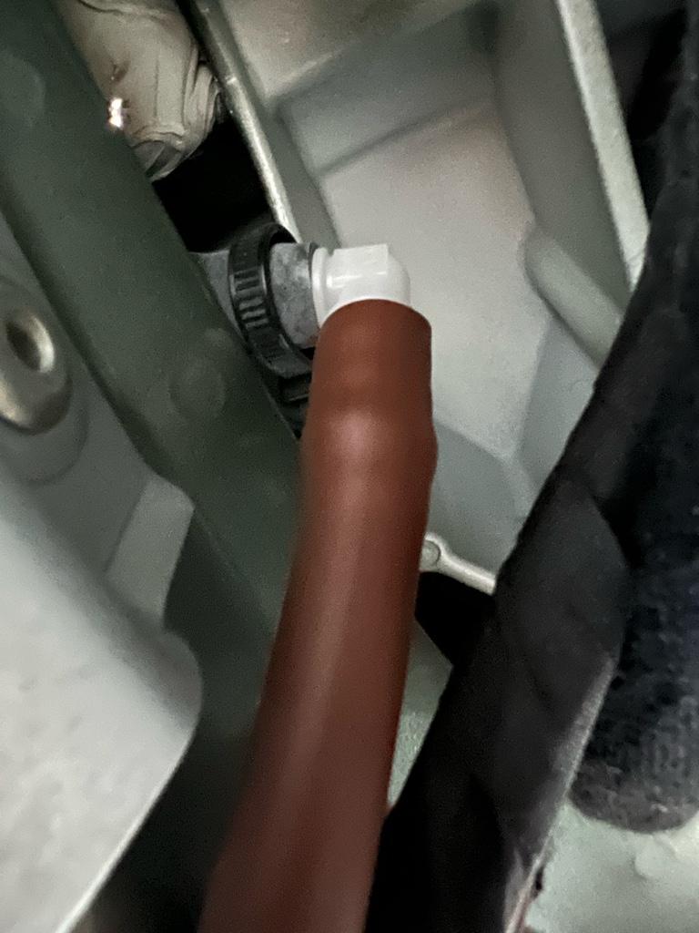

Hi California Lovers,
on my T5 2008 I had a water leak on passenger side, not much, just the roofliner was wet when driving or parking on rain.
Today I have removed the Roof liner and looked at the glue spot as mentioned at the begining of this tread.
Bingo, there were two cracks as highlighte in the picture below. I have applied new layer of sealant from inside, hope it will fix the leak.
Else I will have to go and fix it fom the top.
