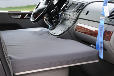

I don't know if this would fit a RHD?
Looking at that I think you could knock one up for a right hand drive.
Piece of plywood, straps and memory foam should do the job. Cost about a third of the price.
Only problem is where to store it?
Nice use of existing accessories but is that the loo holding it up?
The loo is being used to give added support but will use alternative supports when camping. The loo was to hand when taking the photo posted
Also the cushion has 3mm thick plywood inserted inside the cover to give it some added stiffness
