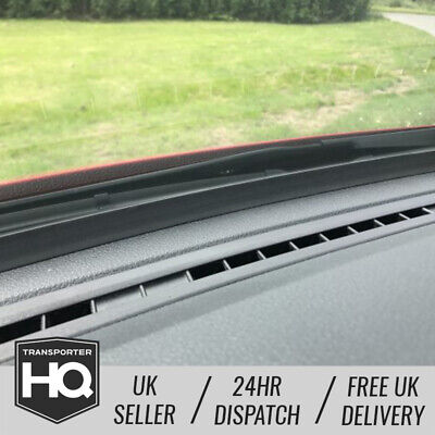

Here's where I bought mine although there are others, some cheaper, this arrived quickly and was just the job. I trimmer the ends to fit in the corners but it is difficult to get the exact length so I cut the strip in half, trimmed an end of each half to fit neatly into the corner and the trimmed the centre where the two halves over lapped before super gluing the halfs back together leaving about 50mm left over.

Me too, is it obvious to you which way the profile goes in??

It isn't that obvious, but I read that the "sharks fin" is the bit that goes between the glass and the dash. There is a fitting video on YouTube.
I finally got around to fitting this today, very easy and all done in a couple of minutes!
The thought occurred to me that an unintended bonus is that any condensation on the inside of the front screen when camping will no longer be able to dribble down into the gap that the dash trim has now filled. This was never a major issue but sometimes when wiping the screen beads of water would dissappear down the gap......... maybe not a problem? but always 'felt wrong' when it happened.
Either way, I won't have to worry about losing stuff (that I never have in 3 years!) now :D
