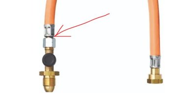

Where is the crash sensor?I lost pressure a few days ago and had gas smell in the closet so I guess it dumps some leftovers in the hose / system when shutting down?
It was fine and no smell after turning it to green again however.
Have you checked the regulator crash sensor ?
Are you referring to the hose between the bottle and the duo control?I had a leak on the flexi hose which has the rupture protection valve.
