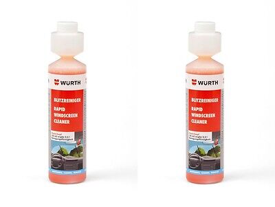

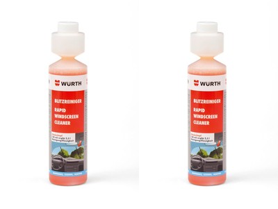

Also, I can recommend this stuff. Really good at removing smearing road grime from the windscreen.
Wurth Xtreme Clear View Windscreen Screenwash Nano Pro 1:100 250ml​
