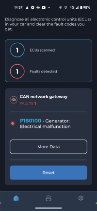

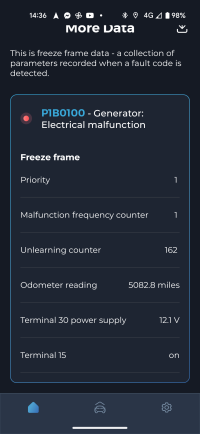

My Nov 24 California Ocean 150 has come up with a generator error, it's booked in for a warranty repair but anyone else had this.
See attached Carista screenshots
Any symptoms?
Fortunately happened on the very last part of a Journey home from Wales, dash warning came up with red battery display and a warning to stop, I could watch the battery voltage dropping as we continued the last part of the journey, it got us home on the remaining power.
I did try to clear the fault but it returned immediately.
Van was running fine but battery was not charging.
Looks like it may need a new alternator. Sometimes the diodes just fail.

Van in at VW today, on a collect and return, they have ordered a new alternator which will be delivered and fitted on Thursday, they did not go into any detail on what exactly went wrong with it.
