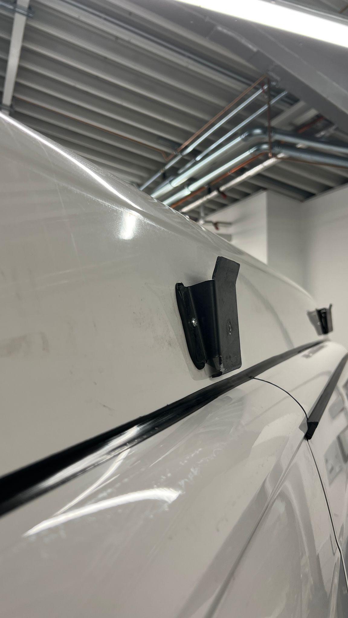

There is a recall for the third brake light seal replacement. I had it done yesterday at my local Volkswagen dealer at no charge. I am out of warranty.
Volkswagen Commercial Vehicles has revised its TPI number 2067615, which deals with the problem of the 3rd brake light.
and
If your GC is still under warranty it is a warranty fix. There is a VW TPI describing the issue & fix.

I had the 3rd light sealed by me using aluminium tape, a couple of weeks ago it was "fix" under vw instructions by my local vw dealer. Unfortunately I have water leaks again.
Seems an odd fix and not inline with the official TPI. This is the UK one.

Thanks reimajarvinen. After a detailed checking on the seal of my GC I found 2 places with detachment between the silicone and the hard roof. Very dificult to see with the black silicone, but I could push a credit card on the gap. I have an appointment on my vw garage for another unrelated issue the 9th of January. Will see if I get something done. I am out of warranty.At the moment. I cover the areas with tape.
