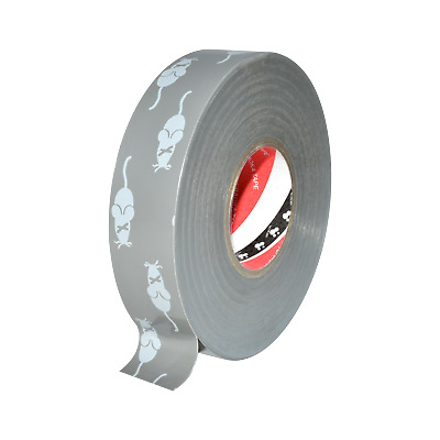

I don't think so. Happened to me twice and I then bought the chilli tape on Ebay and covered anything I could see. Not happened since. A very grubby job.
Some people have covered cables in foil type stuff. If you search there are numerous threads.
I don't think so. Happened to me twice and I then bought the chilli tape on Ebay and covered anything i could see. Not happened since.
Chilli tape certainly sounds like an option - thank you!
