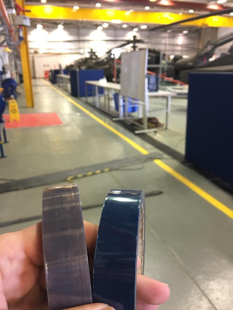

This is the stuff we use on our aircraft, comes in different thicknesses and widths
Is it 3M tape? Do you apply it wet or dry?
I'm currently thinking of buy a roll 3M, being a well known producer of quality tapes. In fact I think I've read they invented helicopter tape.

So there are a few suppliers, mainly American but these were 3M and AMT but we just demand a stock number and have no idea on which manufacturer will turn up.
