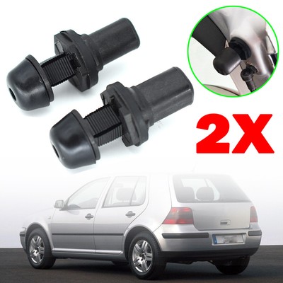

Hello, i am after some help with identifying the part in the image , it is the tailgate stopper on my 2011 Cali , the right side is missing the end piece.Where can I buy a replacement?
Thanks for your help.
When you get the new one just remove the rubber bumper and fit it to the exiting, saves mucking around with removal of the exiting base and refitting the whole new part.
Three images explain how the part is adjusted if needed ( if after fitting The new part: your tail gate rattles the part will need to be adjusted)
Despite what it looks like, the body does not turn, do not attempt to put a spanner on the part, despite it looking like it should rotate. the two plastic parts simply push together and are locked in the position with a small Allen screw ( accessed via item 2 in the first image)
6X0 827 499 F part number about £10 from vw

Is it just the rubber bit that you need?
If your still struggling, and don’t use a bike rack, I have a spare that you can have. Just send me your address and I’ll post it.
Yes it is just the rubber bit , thank you for your kind offer. How do I private message my address?
