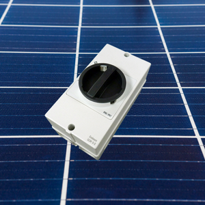

Hi - just noticed this on ebay for an installation I am working on. I have a Victron MPPT 100/20 but my isolator switch is a little different - it attaches via screws (no bracket) and is 12cm tall x 5cm wide. Will it still fit on the right of the housing?
yes the holes are there to help make it easier but you can drill or make your own in the side panel not a problem. If it is 12 cm tall then it will hang down slightly but i could make you a longer version, the 5cm is fine in terms of width. (or the current version you could just screw in a panel on top of the existing one which has the length you need, if that makes sense)

Looking at the image above the switch would need to go to the right of your blue arrow head. Exact measurements of switch back (which is flat) are 11.9 x5.0cm - would a slightly longer length mean it would fit between the lips on the mount? If so I'll have one!

so side with mppt is 102mm tall, 155mm wide. the side for the isolator is 138mm wide.
Can you make one a little taller to fit my switch? Thanks!
yes i can make it an extra 20mm (2cm) so height would be 120mm (12cm) in total top to bottom and 5cm wide is no problem. If you can send me an image of the back of the unit and also with the position of the screw holes i.e. 2cm down from top and 2cm in from right or something like that i can add the m4 bolt holes so you can just screw the m4s straight into the unit (i would imagine 8mm m4s with be fine?)
