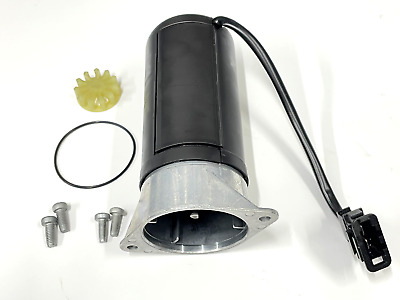

Question about defective hydrolic roof pump.
Is it possible to take the pump motor out and test it and put it back in if it still works? Does anyone have any experience with this?
Apparently motors are also sold separately.

Could be the wire but more likely 5 amps is not enough. Normally a direct supply from a battery fused at 20 or 40 amps. Need to check the value of the roof fuse but out and about at present.
Found it 30 amp fuse under passenger seat RHD.

You are correct.
I have now taken electricity directly from the battery with a 30A fuse. Positive result. Pump is still working.
My problem will be with the sensors.
