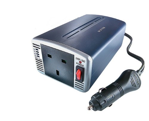

I installed this one. I removed the 12V plug and connected the cable straight to the leisure battery. Sits on the floor behind the LH seat. https://goo.gl/2HnrB7
I plug this charger (upside down) in the inverter to charge our phones, Kindles and MacBook: https://goo.gl/ZwXBMz
Works fine so far!

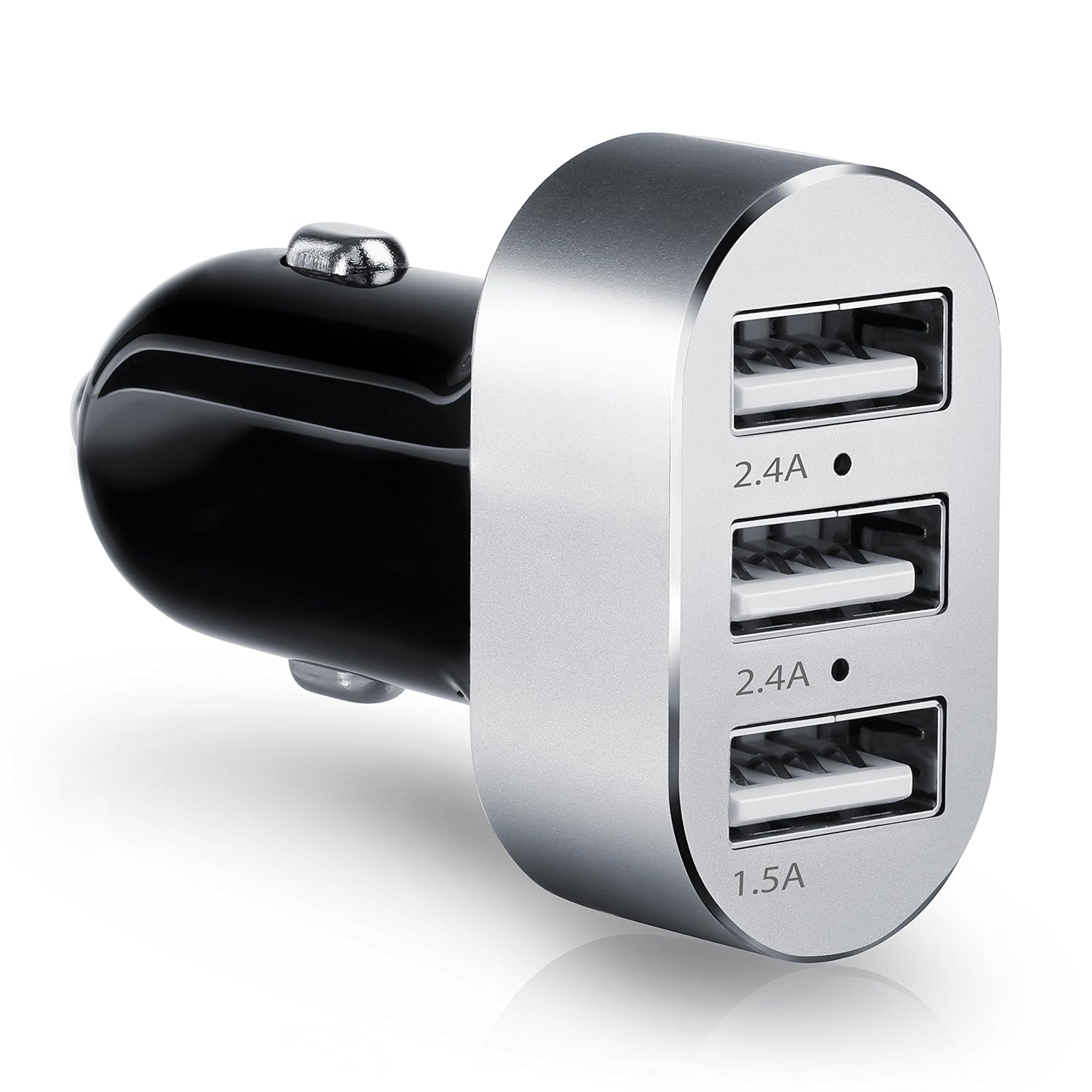

If you get a 12v charger with decent ampage you will not have that problem. Inverters arent the most efficient use of a leisure battery in my humble opinion and are generally designed for use when the engine is running. Unless the device can only work from 240v I wouldn't bother with one.
Many cheap 12v chargers sold in garages are 1a or even less, this proves insufficient for modern smart phones and tablets to get a fast charge.
I use one of these and it charges just as quickly from 12v as from 240v even with my ipad2.

We have a decent 2.4 car usb charger but it's the macbook which is the main charging issue as we use it for films for the children when travelling so would be on the move when needing the inverter most of the time but it's a nice to have option for other things too.
Works fine so far!
https://www.amazon.co.uk/gp/product/B015ORSC0S/?tag=eliteelect-21
Sometimes have similar in Aldi. The 2.4A usb is ideal for smartphones and tablets. 1.5A will not give iPhone a thorough charge in my experience.
