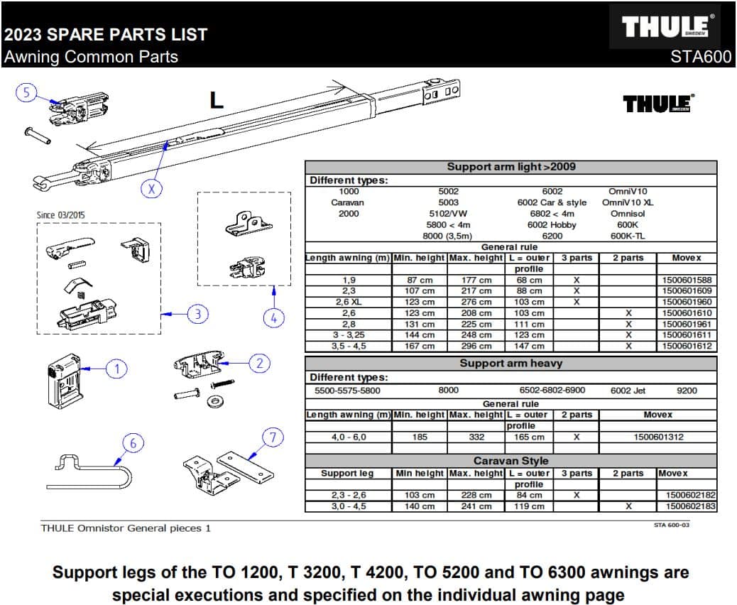

I have had less than wonderful experiences with the "factory" awning that came with our T6 (Thule 5102, VW606). We had to have the cloth removed out and sown together where glue separated and it began pulling into two pieces.
Now the soft plastic clip on the drop down legs that is used to hold the height of the leg in place (see image) is cracking and ready to break. There is no Thule dealer in Tenerife Island. I will have to replace entire leg from a company in the UK, if I can't Macgyver a way to fix or replace the clip that holds the height.
I need Macgyver!! Has anyone Macgyvered a cracking/broken leg clip? I would appreciate any ideas you might have to repair it or some homemade replacement. THANK YOU!!!! :)

You can buy replacement clips for about £15 (eBay)
very easy to fit.
i am sure the club shop would be able to supply or rose awnings.

Part 3 £12.50 from Rose Awnings. But check.

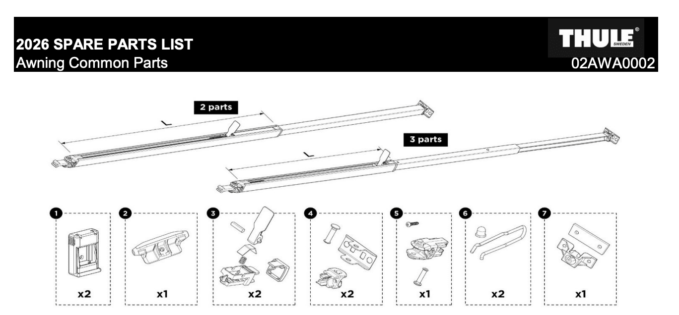

One of mine broke while on holiday a few years ago and I managed to lock it so it stayed in position with a tea spoon handle jammed in a gap between the clip and leg and later found that a screwdriver also worked.
When back home we had the whole awning replaced under warranty for this, at the time it wasnt possible for VW to replace parts and they could only replace the full unit.
I love the tea spoon idea! I carry a tea spoon in my driver's side door along with other misc. items that work to "Macgyver" all sorts of things! Great idea! If I have too many more problems with the awning ... I may goto the dark side and get a Fiamma. I'd actually like a longer awning but it might be too dorky to have an awning that stretches towards the front bumper. :/
I remembered more detail now, the lever on mine developed a crack so locking and unlocking was difficult as leverage was reduced / lost (it did eventually snap), wedging the spoon handle behind the plastic clip gave me back the leverage as I could get the clip to move and continue to use the awning. Towards the end of the holiday the lever started to twist, I think I eventually damaged the pivot pin or rivets by using the spoon which is why I thought the warranty claim might have been rejected.
If repair / replacement of mine had been refused under warranty I was going to identify a couple of positions that were used most and I was going to drill thru the leg so I could use the hole to lock in position using something like locking nut and bolt but I haven't explored this further to confirm that it would work. At the time a replacement would have been £800.
Obviously spares are available now so the awnings are more serviceable.
