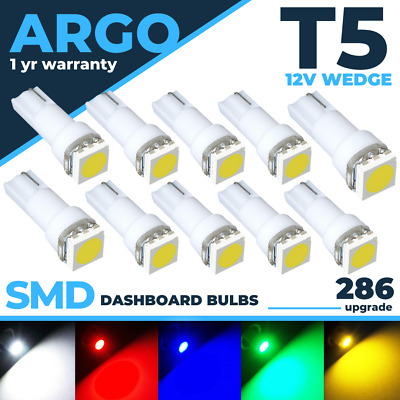

I've just installed some of these into our 'California' lights. They only have one contact on each side, so there's no need to scrape anything off as described earlier in this thread. The listing highlights that they're not guaranteed CAN bus error-free, but mine haven't thrown any errors and to be honest I wouldn't be surprised if it's something that VW simply don't monitor - they're hardly essential for the operation of the vehicle.
I hope for you they last longer than the first set of single LED bulbs I bought. The only problem that can occur is through the dimming function. Inner lights (and in mine from 2010 even the outer lights at the front) aren't monitored by the BCM, so you don't need CANbus LED's for those. Only if you have CANbus light switch (small plug) there is front light control.
